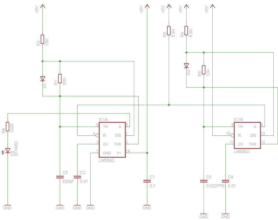

Here is a 555-based oscillator that may do what you want. All capacitors are in uF, unless noted. I used polystyrene for my timing components. You can use regular ceramic or mylar (polyester). IC1B modulates IC1A. The carrier was 38Kz. I used an LM556, which is just 2 LM555's in a single package. You can use the pin names to redraw it using two 555's.

John,
this is what I meant - one 555 is controlling the other ( just did not had the schematic in hand ), no need to use the logic gate, just need to add a transistor and more LEDs ;), probably to adjust R6 for good biasing of the switch transistor - if the transistor is BC337, it can carry 10 LEDs without a problem, base resistor about 1k :)

well it's not working again here's what i got:
My original circuit instead of a 555 a 556 is in its place
The 556 is used for the following along with the original circuit.
MULTIVIBRATOR
R1 -10 ohm resistor
R2 -68 ohm resistor
C1 -0.01 uf capacitor
When I turn the circuit on the 556 gets 95F degrees (Very hot). and there are no kHZ getting to the led. Does anybody know why this is happening?
There is something wrong ... it should not get hot. Check all connections again. Try to make the circuit as proposed by jpanhalt and add the final stage - more leds and switching transistor as I wrote previously.

check power supply, this is usually where you have to start ... then look at the outputs - pin 3

It does not get hot until i connect 5 to 10 (output to reset) on the 556. Any ideas?

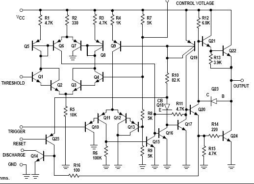

That doesn't make sense. Pin 5 is output from one 555 section (IC1A). Connecting that directly to your power supply would not be good. True, 555's can source or sink, but that would create almost a dead short to ground.
Here is the schematic of a 555 so you can see what I mean. Q22 and Q24 are the output transistors.
Are you absolutely sure you connected pin 5 directly to V+ supply? Do you have the reset (pin 10) connected to the supply?
