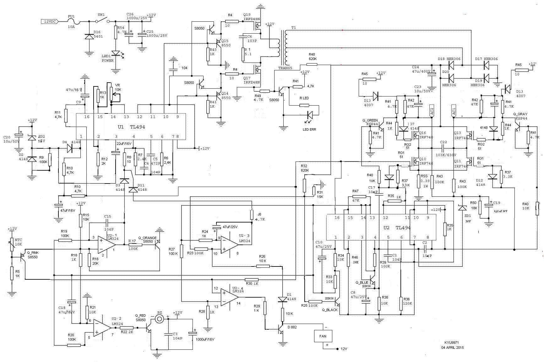

Hoping to be helpful to other users, I redesigned the circuit following step by step the tracks of my inverter.
I found many differences from the diagram taken from web.
Now you can understand better.
Thanks for any help.
I'm sorry but the source was already ' blurry .
I just redesigned the circuit properly , as my inverter .
erchiu

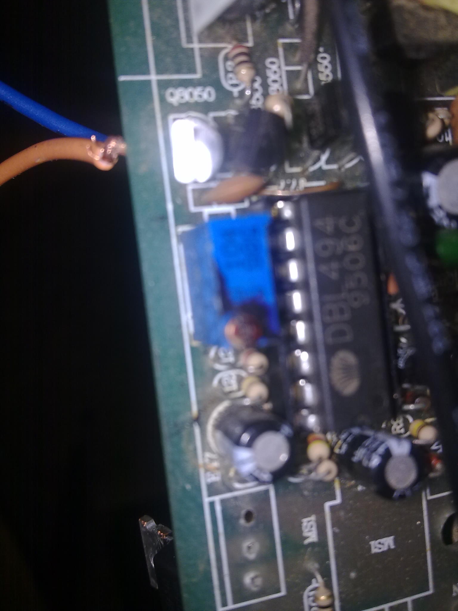

Ok, i found the resistor R32 broken, i have replaced it and the second stage started to work.
With my instrument i read 216 vac in output, but on the capacitors after the rectifier bridge i have now only 250vdc and with my scope i see an perfect modified sine wave but with 250volts of peak.

your schematic diagram is not clear but changing the ref voltage at pin1 or 2 of TL494 will lead to change of the duty-cycle of the pulse and therefore changing the output voltage

this is the diagram saved in jpeg format
note: the VR on diagram is from 100k instead 10k

Sorry if I insist , but the digraph that I found on the internet was in gif ( about 100kb ) .
I have changed to " paint" to make it equal to my inverter .
I do not have many programs to optimize this file . Can I somehow with "paint " to make it more ' clear?

thank you,
between pins 14 and 15, there is an variable resistor (it is from 100k, instead 10k my error)
can be it to set?
If the original GIF image is fuzzy then Paint program cannot make it look much better. Saving it in JPG will add the many little dots around text and line junctions.

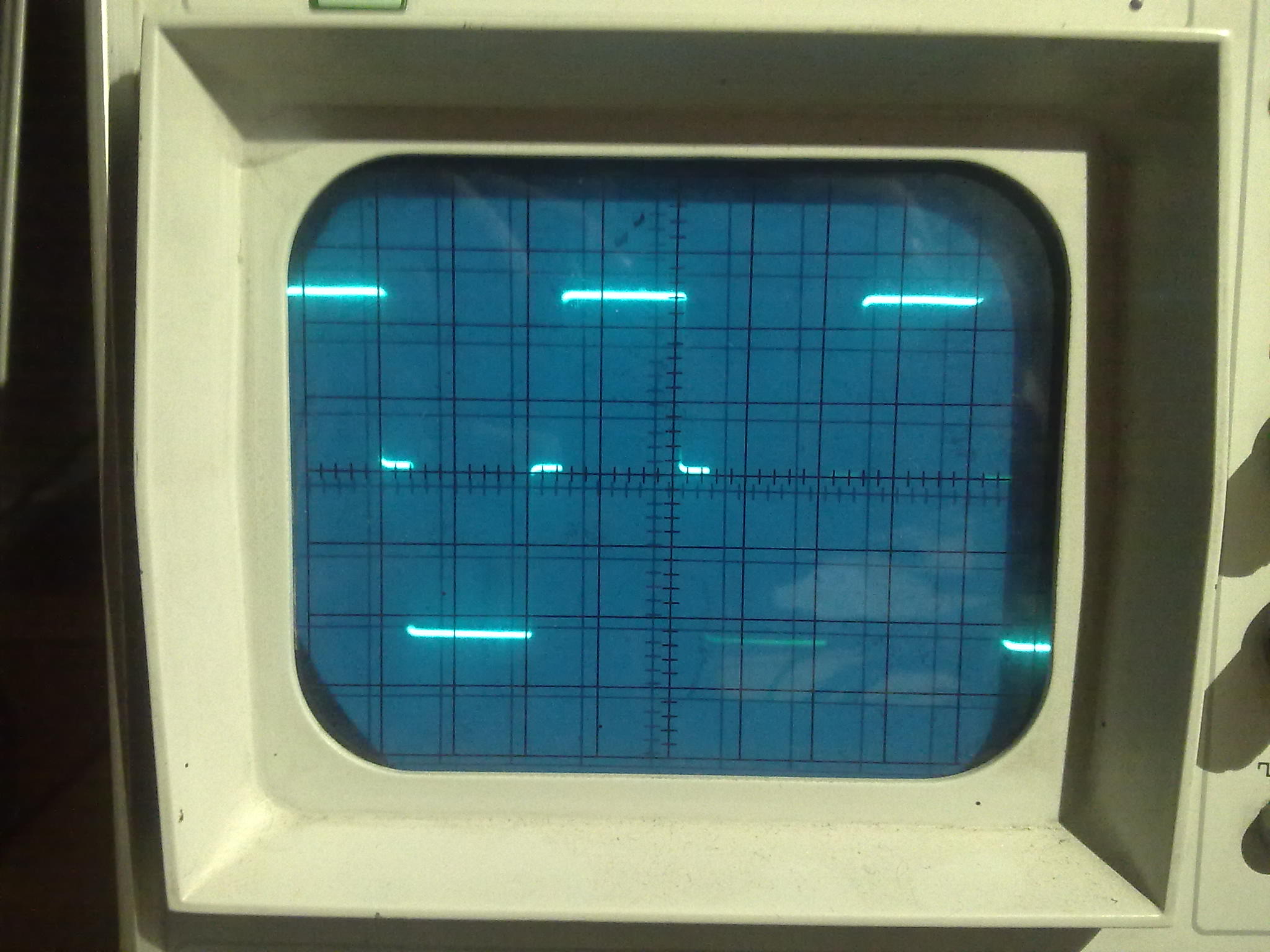

i tryed to set the variable resistor (100k) , doing it 10 turn to right and 10 turn to left, but the voltage on capacitors is always the same 240 vdc and the peak of the wave form in output is 240 volt.
the wave form as you see from picture is perfect (i guess).

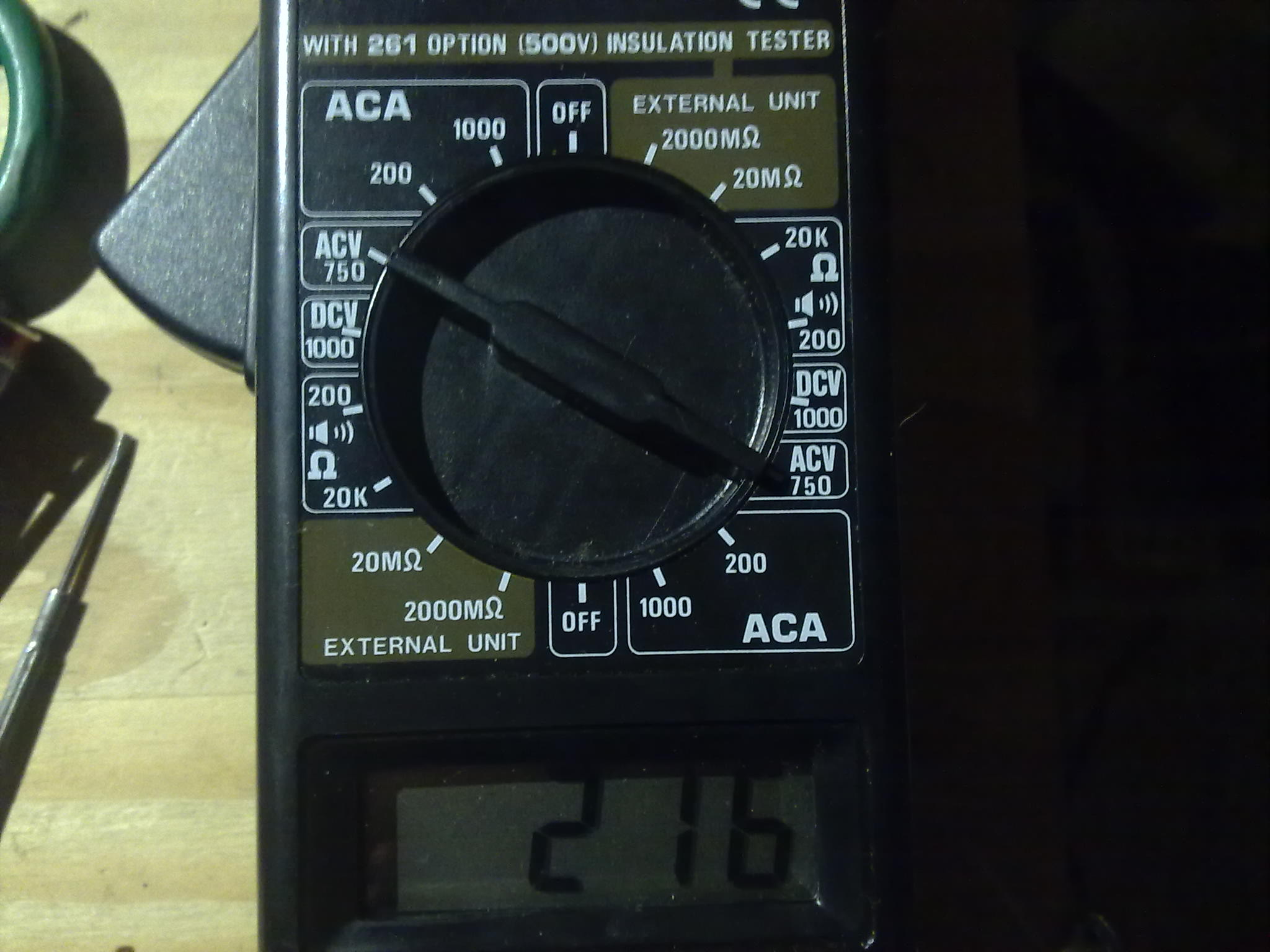

i measured the output voltage with a tester in AC position and i read 216 VAC.
I too got unexpected low AC volt readings on my meters, when I hooked them up to my modified sine wave inverter. My inverter was working fine. However it is because the meters are calibrated to measure sinewaves, not square-ish waveforms.
It is not bad. I imagine the waveform remained a longer time at 0V, when the inverter was new. But you have success now, compared to having an inverter that's not working at all.
You have 240V peak on a square-ish wave. This carries approximately the same power as a sine wave with peaks of 330 V.
