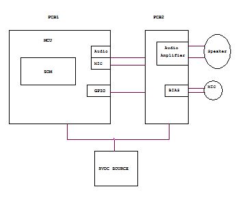

Using SOM based mixed signal processor module and Its provide Audio & Mic signal through Berg connector.

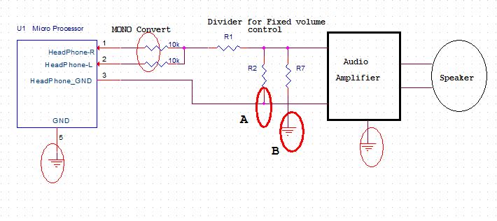

i'm using 4W mono amplifier IC with differential input, instead of using volume control (Trimpot) i plan to provide fixed resistor divider netwok for fixing audio volume.
MCU audio channel out signals = Headphone L, Headphone R & Headphone GND; Mic + and mic -
As per my post17, can i use resistor divider reference gnd as Headphone GND or common gnd
Please suggest

Please find block diagram and audio fixed volume resistor network GND
My application not require to adjust volume, that's why i want to provide fix. volume.
Yes, Processor have volume control for headphone output
differential inputs - Processor have provision for differential output and my amplifier IC input also have differential inputs. pls find my image
(Audio output terminal have Headphone L, Headphone R & Headphone GND signal )
Which GND can i use for divider resistor ground reference? Headphoen GND OR common GND
Pls. suggest
Thank you

A differential output has a + wire and a - wire. Your headphones output is not differential, it is simply a single-ended left channel, a single-ended right channel and a ground.
We do not know the input sensitivity of your power amplifier, the headphones output levels might be fine feeding it without voltage divider resistors. Then adjust the volume with the processor volume control.

I used PAM8303D Amplifier chip for your reference
Thank you
The two 10k resistors add the two stereo channels together into mono. Their parallel value is the input resistor for the amplifier. The datasheet for the amplifier says that the input resistor should be 150k for a differential gain of 2, then each resistor is 300k, not 10k. Your input is single-ended, not differential so with two 300k input resistors then you do not need the 10k resistors and do not need your R1, R2 and R7.
The 300k resistors produce a single-ended mono gain of 1. If they are each 600k then the gain is 0.5 times. If they are each 1M then the gain is 0.3 times but you and I do not know how much gain you want.
The datasheet shows that the amplifier input resistors need coupling capacitors and the unused input pin5 has a series resistor half the value of the input resistors and capacitor to ground.

As per the attachment in post# 27, my Audio channel source provide Headphone GND separately and Analog audio GND separately. Can I consider it as a differential signal?
As per your input, I have modified the circuit with differential input. Please find the same attached with this post.
Can I put the Capacitor before resistor (as per datasheet)? Your recommended circuit (Post #29) has capacitor placed after resistor. What is the difference?
What frequency range should I consider to calculate input series capacitor (C=1/2*3.14*Fci)
Please suggest
Thank you
Rajan
Your headphones output is a stereo single-ended output, not differential. Since you are using the headphones output then you should also use the headphones ground.
My circuit uses only two input coupling capacitors, your circuit needs three capacitors.
The calculation is c= 1/ 2 x pi x R x f where R is 300k or 150k and f is the lowest frequency you want which might be 20Hz.
