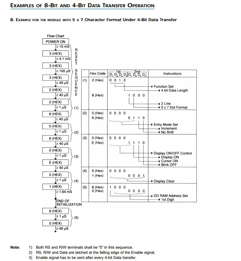

The initialize is it this one?:
I think the problem is this: WriteCmd(CLEAR_SCREEN)
This is the initialization algorithm, 4 bit mode:
Yes i added delay before and after screen command and its working but alexx said that "This will not fix the problem, but it will help you understand what is going on, before the second print."
This delay pointed out the suspicious point, but it is just a debugging technique. It cannot be used as a real world solution, because the lcd will be left blank for a long period of time.
So after that and by reviewing the datasheet, someone can observe that the execution time of clear screen command in 4-bit mode, is 1.64ms after the second nibble.

void Delay20TCY()	//20 clock cycles, 2.5mS
40MHz means 25ns. 25*20 = 500ns. This doesn't meet the requirement of 1.64ms. I'm not aware of PIC or the compiler you are using, but I believe that it is time you gave a second look into your delay functions.
If you need an opinion, clear screen command is not necessary after initialization. Just write over previous screen and that's it!
