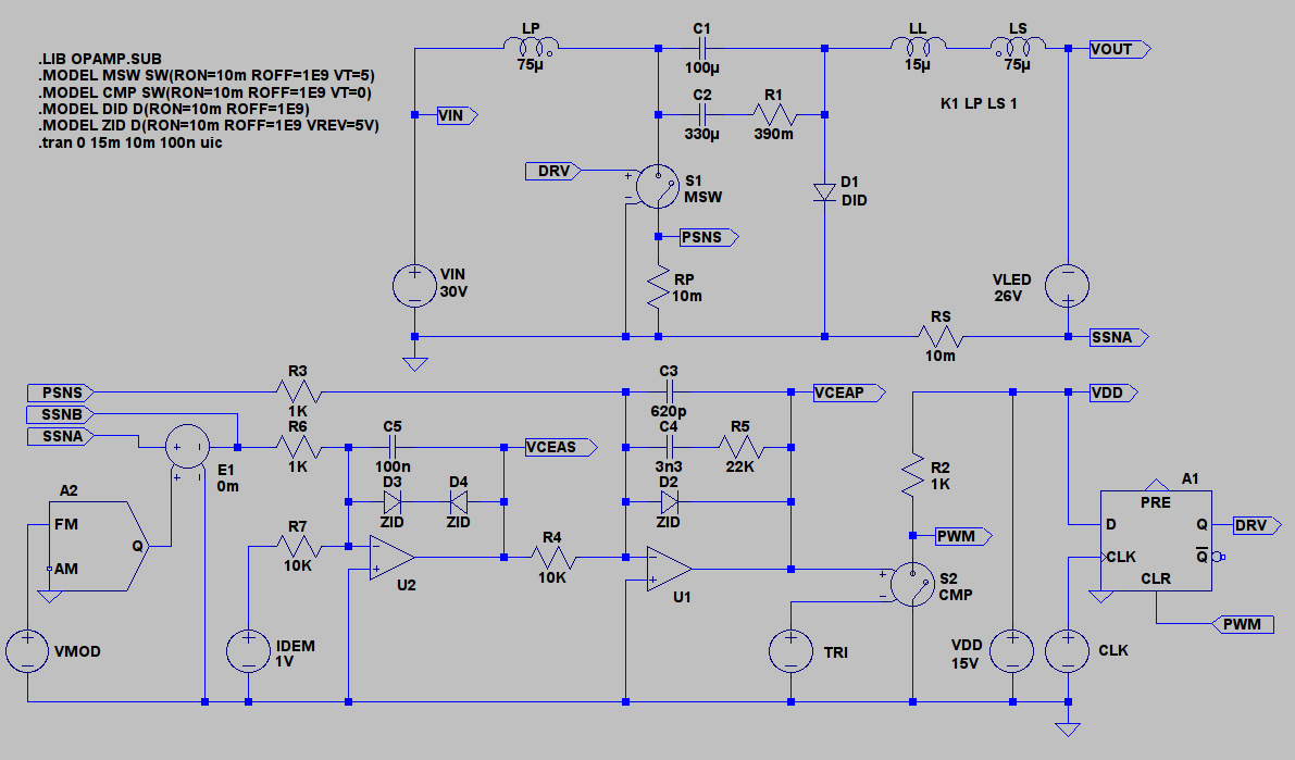

Since you have LTSpice, which is 'nice' have a look at this.

Hopefully if you copy the above code and paste it into your text editor then save the file as a .asc LTSpice should recognise and open it for you. Shout if it does not work.
I've added * C:\LED\cuka.asc at the beginning which is where I saved it.
It is a coupled inductor CUK converter and I will not deny that I am 'guessing' at things and it will need some work to qualify and sort it. Depends on whether you wish to invest time in it but, hopefully, the result will be 'nicer' than what you are dealing with at the moment.
As per the links given in..
https://www.edaboard.com/threads/198743/#post838978
I am using average current mode control of the 'primary' switch, S1, to avoid external resonances which may not be controlled. The coupled inductor would/will be designed to place leakage in the output steering ripple to the input. This will be a custom design. I can do that.
U1 controls the 'primary' switch current which, as detailed by Dixon, will be the input current. As he explains in the the application note component, C3, is selected to achieve 'slope matching'. I have not analysed it, done the sums properly. I took a guess at R5/C4, C4 was 'easy' and it worked.
With that in place U2 controls the output current supplying a 'demand' signal to U1. That was an even bigger 'Guess' but it works also. I've got E1 and A2 in there to look at what the loop gain 'really' is.
One thing you will probably notice is that the model uses 'ideal' components.
It really helps to do that because you get the chance to poke around and get some estimates about things rather than being told 'non-convergence error at iteration 268 problem with node 0028'. You might get one of those anyway.
As it is at the moment there will have to be some gnashing of teeth in order to sort out the way error amplifiers are configured to get it single supply and other things. For the moment it is just 'proof of concept' but it will give you/me the opportunity to look at operating waveforms and be bothered about device stresses in terms of current, voltage and power dissipation.
Here it is in 'regulation',
Start Up will give you 'Kittens' but I should imagine there is a way of overcoming that.

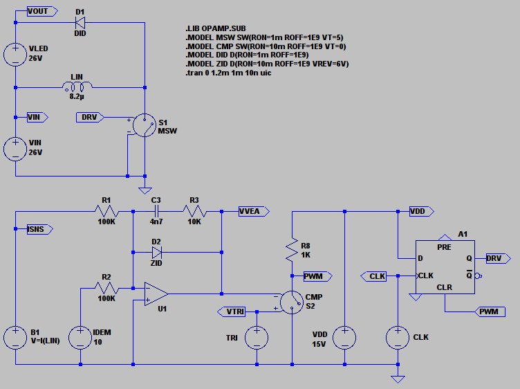

Try this,
* C:\LED\ledboost.asc
LIN N001 VIN 8.2µ
S1 0 N001 DRV 0 MSW
D1 N001 VOUT DID
VIN VIN 0 26V
A1 VDD 0 CLK 0 PWM 0 DRV 0 DFLOP Vhigh=15 Vlow=0 Trise=50n Tfall=50n Td=10n
S2 PWM 0 VTRI VVEA CMP
R8 VDD PWM 1K
VDD VDD 0 15V
V§CLK CLK 0 PULSE(0 15 0 10n 10n 500n 12.5u)
V§TRI VTRI 0 PULSE(5 1 0 12u 500n 0 12.5u)
XU1 N002 0 VVEA opamp Aol=100K GBW=10Meg
C3 N003 N002 4n7
R3 VVEA N003 10K
D2 N002 VVEA ZID
VLED VOUT VIN 26V
B1 ISNS 0 V=I(LIN)
R1 N002 ISNS 100K
R2 N002 N004 100K
V§IDEM N004 0 20

I am guilty of not looking too closely at the Maxim data sheet to see how it thinks it might be working but the upper section is representative of your power stage. VIN is Boosted up over VIN to VLED sitting on top of VIN.
I've set VIN and VLED to be 26V which should give me, ignoring other things, something like a 50% duty cycle. Otherwise it is a bit of a 'Fudge' but does demonstrate some of the issues in your present circuit.
The 'Fudge' is the way I am controlling things. That is the lower half of the circuit. I am measuring and controlling 'inductor' current rather than 'output' current. I'm sure the Maxim circuit does something slightly different but that is not going to affect the resulting waveforms.

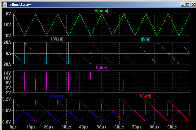

Using your 8.2uH, operating at 80KHz and asking for 10A, total from IDEM set to 10V which will be 5A in and 5A out, gives,
V(ISNS) demonstrates the peak inductor current of 20A.
I(VLED) and I(VIN) demonstrate the peak 20A sawtooths at 50% duty cycle. They average to 5A. Half Peak and half again.
V(DRV) shows the 50% duty cycle.
The bottom curves just demonstrates 'slope matching' in the error amplifier being used to control things.

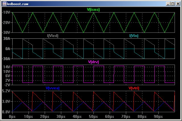

If I set IDEM to 20 for 10A in and 10A out, with 10A out being your maximum figure then the result is,
The inductor current has become continuous (and it will gain the Right Half Plane Zero) but, and I did not spot this until I modelled it, both the input and output currents remain discontinuous and that makes your input and output filtering problems even worse.
