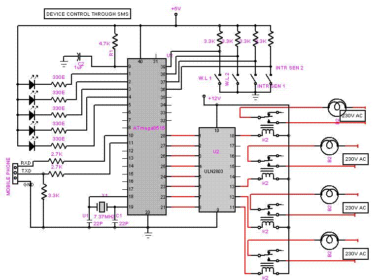

Hello.. i found from other site, for controlling devices by sending sms commands, the circuit diag is attached,, but i dont know where the txd rxd pin is to be connected in mobile phone,, can anybody plz help me out with this ??? i m really desparate abt making this project,,,,

tariq7868, well it is a good ciruit diagram,i don't know about mobile phone connections however if have interfaced GSM modem WISMO Quik 2403A
If you see the modem interafce you would see the following signals on it:
TxD,RxD,DCD,CTS,RTS,DSR,DTR,RI
According to this cuiruit schematic if you want to interafce GSM modem instead of the Mobile Phone to the connector of this circuit then you need to connect TxD of modem with TxD of microcontroller,RxD of modem with RxD of the microcontroller and GND obviously is a common signal to both modem and microcontroller.There should be one-to-one connection between modem and microcontroller.
Shorten the CTS signal of modem interafce with RTS signal of modem interafce
Also there is no need for resistors 2.7k and 3.3k,you can connect modem sigals directly with microcontroller
The simulation which i have posted here is only a part of a bigger project that i am trying to simulate on Protues,so there are many extra elements in my circuit diagram.
would you please mention the website from where have you downloaded that ciruit schematic
regards
m.yasir

As far as i have been able to explore,TxD pin of microcontroller is connected directly with RxD of the male connector pin that is inserted into the socket of Motorola C168i
while RxD pin of the microcontroller is connected directly with TxD of the male connector pin that is inserted into the socket of Motorola C168i
while GND is common to both.
These connections are made without involving any level shifter IC like max232.
