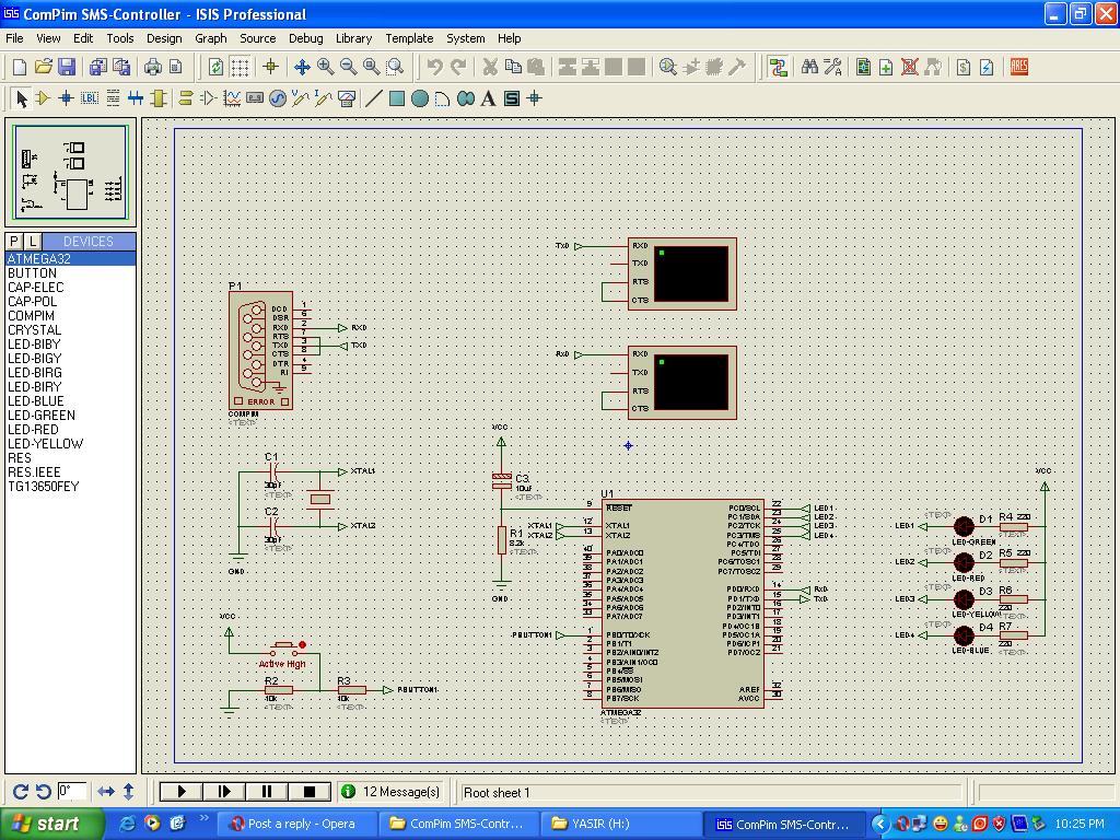

edge modem + microcontroller
thanks yasir9909 for the reply
i started o write the code and i have used microbasic to write it which follow almost the some sequence your talking. Have a look on it.
sorry i think the algorithm of the program is the some even if using different uCU on my side it is difficult to get 8051 uC but i considered pic 16f877 this is my first project am not expert with uCs.

Please it has not yet tested but still am suffering on some problem on it.
sending at commands to gsm using microcontroller
well,its ok to use any microcontroller either PIC,AVR,8051 or some else if it has built-in UART.Alternatively software UART may also be used.
PIC is better than 8051 in terms of functionality and features
why don't you better use 'C' language instead of basic
C is most widely used language for microcontroller programming
i would give more feed back after i go through your code in detail
what problems you are facing
regards
m.yasir

control device with sms 8051
One more thing that i would like you to learn is Proteus VSM.
Protues is a very good simulation software for simulating and testing codes,algorithms and circuits built around microcontroller
I have developed a protues simulation for sending SMS and reading SMS through modem,connected physcially to the serial port of the PC, controlled by protues simuation models of microcontroller and serial port in Proteus
I have used AVR microcontroller ATmega32.
I have implemented following AT commands:
- AT+CGMM
- AT+CMGL="ALL"
- AT+CMGS="+913451234567"
I have shortened RTS to CTS and used only three signal lines: RxD,TxD and GND
for implementing above AT commands
The link to this circuit schemetic is:
https://obrazki.elektroda.pl/11_1245691863.jpg
I have utilized Image Craft Compiler for AVR
regards
m.yasir
gsm ic to microcontroller
Thanks yasir for the picture,
i have got Proteus VSM but am not good enough to do as you did there, the other thing is do you mean that if i connect the phone to serial and simulate it will work the some as a really connected device on a real circuit with my modem?
if my program is perfect it will be able to read and send command to modem?
also can you send you design via my email geev8 at yahoo dot com
how to read sms from 8051
geev,well Proteus is not difficult to learn,it is quite simple if you have got practical understanding of microcontroller programming and electronics.
Yes you have rightly judged if you connect GSM modem (i have used WISMO QUIK Q2403A GSM modem) physically to the serial port of the PC and run this Proteus simulation by setting the parameters of COMPIM and virtual terminals according to the physical serial port,i.e. whether it is COM1,baud rate matching with actual serial port for COMPIM (both virtual and real) and for virtual terminals.You can make the modem, connected physically to the serial port of PC,operate like it is actually connected to the microcontroller in hardware
I have implemented a few commands just to have an idea of how this idea of operating modem through Proteus simulation may be materialized.
Further AT commands and operations may also be tested based on this idea.
i would upload the code here
regards
m.yasir
