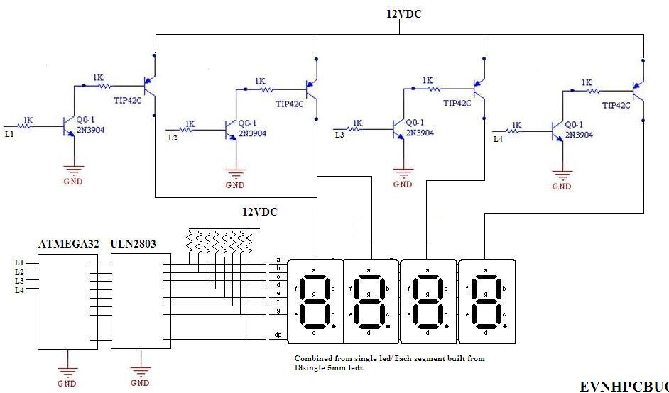

Now I want to display the freq with very large 7 segment display (20cm height, combine from single leds, 20 leds per segment). Can I use the scan technic or will I need any driver?

this kind of display is usually driven with row multiplexing
row1
row2
row3
last row
row1
there is also an alternative to use column multiplexing but because there are much more columns the refresh rate needs to be higher and the leds may be dimmed or flicker.
The scan technique is different because you have to further break each character to be shown in led lines.
The current needed depends on the display but in any case you need an external device (like a transistor) to provide the high current.
Alex

Dear Alex,
As I said, I intend to combine single leds to make big 7segment (20leds/segment, then about 20x7x4=560 single leds in total, some addition leds for decimal point...).
Other word, how to display with 4 set of 7 segment which required high current?
Thank in front.
I'm not sure what you are asking ask, the way to multiplex the leds is like described in my previous post, obviously you will need external devices to control the high current , like a ULN chip or transistors.

I built an actual board as per your suggest...using transistors and uln2803....
But when displaying the frequency....it appeared some "strange" digits (such as "-", "|_", etc...)...(look again, it appear in proteus simulation also)...so i think the program may not well...
The logic high at the input of ULN2803 makes the output active low, ie it inverts. If software sets active lo to lit, now it is turning it off. For example if 0 is to be displayed now "-" center g segment is lit. If this is the case invert outputs in software or use an external inverter ic like cd4069 between mcu and ULN2803.
The logic high at the input of ULN2803 makes the output active low, ie it inverts. If software sets active lo to lit, now it is turning it off. For example if 0 is to be displayed now "-" center g segment is lit. If this is the case invert outputs in software or use an externa inverter ic like cd4069 between mcu and ULN2803.
No this is not the case, ULN2003 sink current when the input becomes 1 and it is connected in the cathodes of the display so there in no inverting involved, it just grounds the cathode side and the leds turn on.
Alex
I understand what you refer...but the logic for uln surely not the cause and I have tried to display some number such as 1234 as good (I can do this test by assigned F=1234 in the program)....the bad display when I applied the freq from the zero crossing...Do you think the data type may cause this problem...?
So main part of displaying from digit registers is ok.This could happen if resetting the display routines wihout leting it to complete. Once rgister is updated stop taking samples and disply. See post #13. Accuracy of calculations, you have to deal afterwords. Can you show the code.

Consider driving directly from mcu. logic 0 on mcu ouput will connect led to ground but in this case it is invertd. uln2003 and uln2803 both invert logic level.
  • ULN2803-D.pdf
  • uln2003.pdf
I think I misunderstood what you said in the previous post, you were saying the same thing I said, that the led will turn on with 1 in the input and turn off with 0 but I miisanderstood that you have to set 0 to light the led.
Yes a common emitter output inverts the signal
Alex
