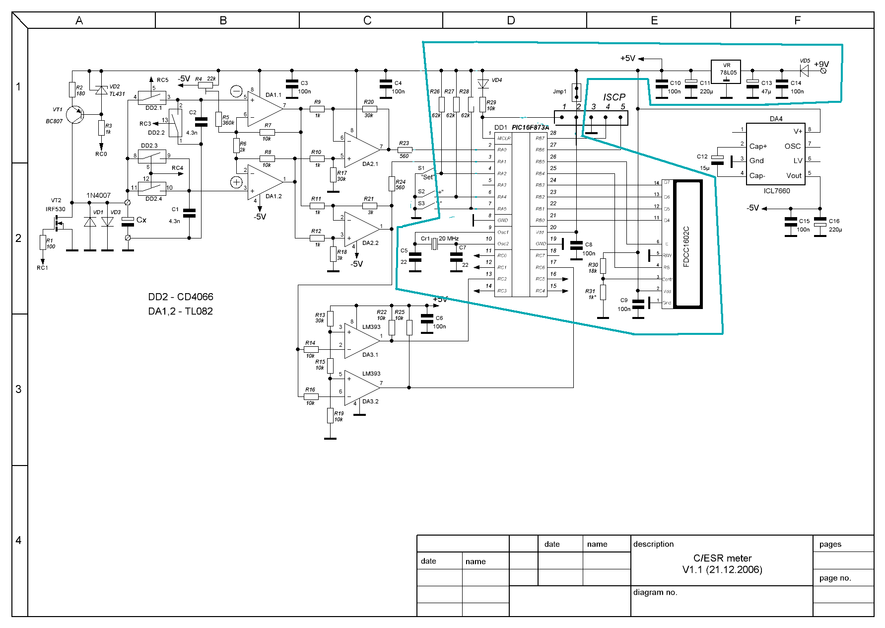

To Haran24 and Emiliojuan:
I don't see the 20MHz quartz cristal and the 22pF capacitors.
Try to reprogramm the PIC and check if the fuserbits are set like this:
Try to verify if the PIC is writen correctly: Read from the PIC and save to file and compare the reading from PIC with the original hex file.
The circuit can work with the minimal components, like in this picture:
Good luck.

Well there is a progress on my ESR photos attached. The thing is i'm not familiar with pf Caps so i used 220(the digit) after i replaced with (22) the digit i hope it's the right 22pf cap i'm getting the display below.
What i'm getting both rows lit; the first row with a solid box and the bottom with 0 but if press the button for(+) the zero turns into ( ? )when i release it goes to 0 again.
My programmer, it wouldn't work with other software you recommended & its only works with MPLAB IDE and Pickit 2
Also i did checked the fuserbits the way you instructed 3F32 still no luck.
The hex file i compared its puzzling me because the way it looks different the top 2nd and 3rd lines are missing and some other extra keys also showing. So i programmed a different type of PIC 12F683 with fader LED program it also didn't match with original But it's working grate . Exported file attached
Moreover i isolated the circuit on a breadboard just PIC , the LCD, 1N4148,10k,20MHZ, 22PF and 62Ks i'm getting the same display
Any ideas?

Hi buddies, Well there is a good news my project succeeded 75% only. Now the display's working and showing everything the problem was there was a invincible solder bridge between D7 & D6 on the display panel PCB continuity tested failed but a magnifier found the bridge.It's all my bad because i didn't solder properly.
Now the problem is it's not showing the capacitance value what could be the problem. Which area it could be? I used several electrolytic caps but it's not showing CX value. photo attached.
Thanks for your precious time
Re: ESR Meter
Check VT1, VD1, VD3 area for other bridges. Then check LM393 area.
Without capacitor on test leads ESR must be greater than 11.xxx
If that picture is without capacitor, then is a bridge in the test leads area.
For calibration, please read the first page of this thread.

Thanks Pal, Without Capacitor it shows ESR 0.000 and i couldn't find the calibration on page 1
MY CONFIGURATION IS
VT1 = BC327 (is it okay to use this Transistor?)
VD1,VD3 =1N4148
There is no bridges in LM393 VT1, VD1 & VD3 areas now i'm worried what's going on ? Please help me I'm really sorry to bother you my friend
