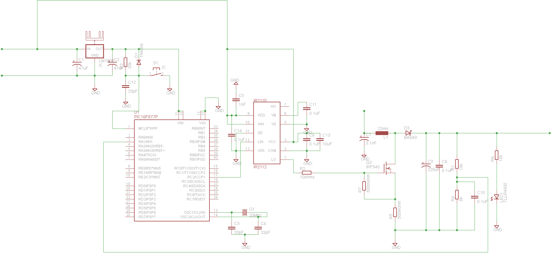

thanks.. i came across this boost converter circuit that uses some other mosfet and drivers. i need it modified to suit my application.. i have very little time to finish the project so i need some help here.. i m currently doin the programming for the PIC control of my boost converter.

You can take the MOSFET, inductor, capacitor etc - ie the power boost stage - from this circuit as it is pretty much the same for all boost converters. You'll need to change the driver stage, using your driver. Also, change the feedback section - here a simple resistive divider is used, so you might need to change it depending on the code; the values are blurred in the picture, so can't read the value.
i did a circuit using cadsoft eagle. can u check it and tell me any mistakes.. thank you.. all the details u want are there..

i got t.. i can export the circuit file to an image.. can u check the circuit and tel me if there are any problems with it??
Connect +12V or more to pin 3 (VCC) of IR2112.
Change value of R2 to around 10Ω to 22Ω. Connect a 1k resistor between the gate and source of the MOSFET. Using a 10µF capacitor in parallel with C6.
Value of L1 seems too large.
Why are you using a transzorb for D2? Use a schottky instead.
Use a 0.1µF ceramic capacitor across VDD and VSS.
If you're not going to use current-sensing, you might skip out R5.
Hope this helps.

ya it helped a lot.. can you just tell me what i need to add if i am going to use current sensing.. i know it involves op amps but i m not sure..and also suggest a value for the inductance.. i will make the changes you asked and attach the diagram soon.. thanks a lot

This is the boost converter circuit with the changes u asked.. i wanna know what to do for current sensing.. pls reply soon thanks

Change the value of R7 to 1kΩ.
Use R5 for current sensing. Measure the voltage across R5 using the PIC ADC and determine what is to be done at which current setting in the code. V=IR, so I=V/R. Use this information in the PIC code to determine the current by measuring the voltage.
Ensure that you connect a small RC filter. You can use a 1kΩ resistor and a 0.01µF or 0.1µF capacitor.
Hope this helps.
Tahmid.
