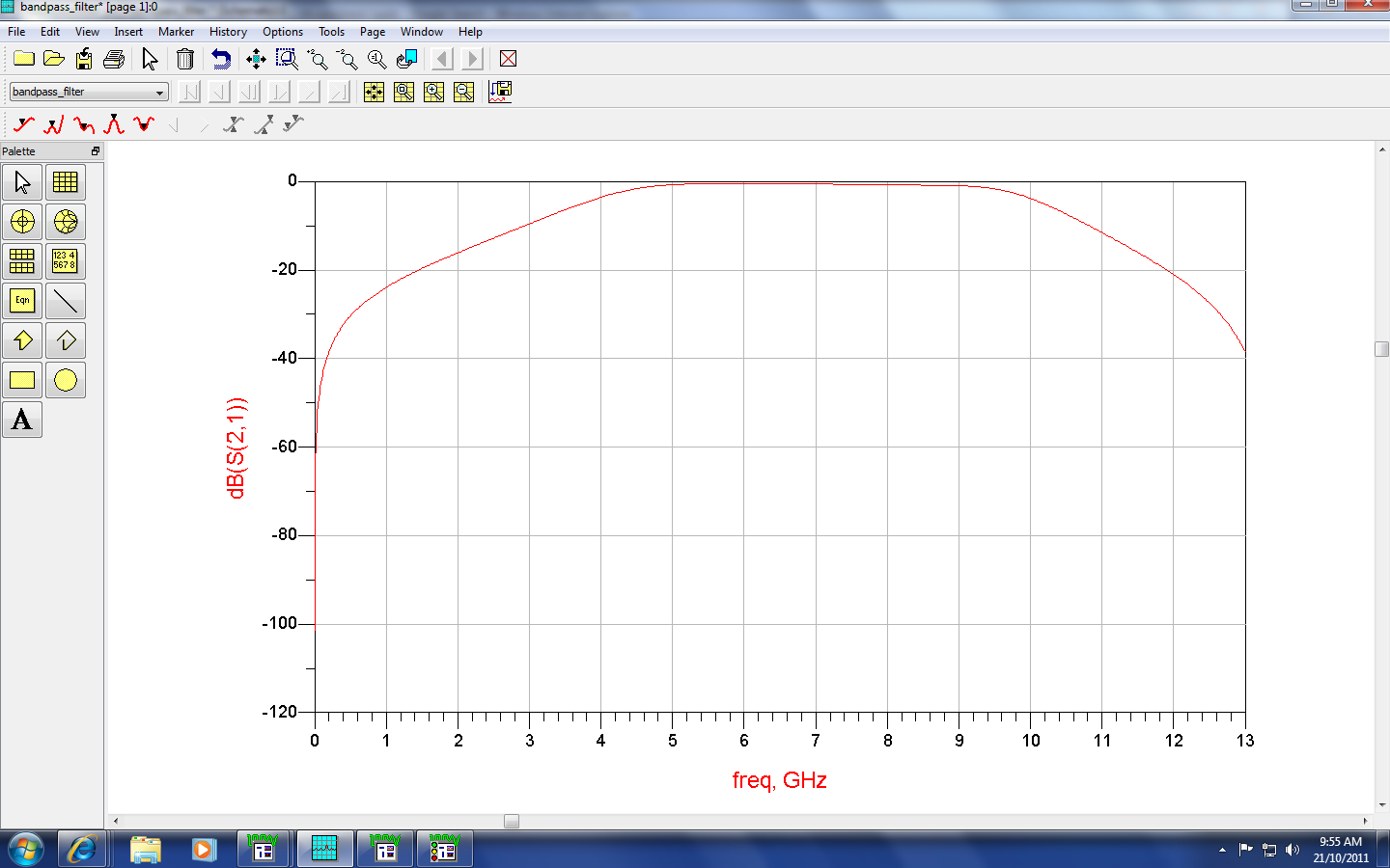

Hi. I need to design a bandpass filter of bandwidth 3.1GHz to 10.6GHz with centre frequency of 6.85GHz. But i didnt manage to get the passband (from 3.1GHz - 10.6GHz). I only had the waveform which i have attached it. Also my lecturer did say about using half-wavelength for TL3 and TL5, and quarter-wavelength for TL1,TL6,TL2 (Schematic attached). I had no idea how to change them to those assigned wavelengths. Is that the reason why i couldnt achieve the passband? Please help. I'm lost. Thanks.

first, your circuit should be near from the picture that i upload.
You have MCFIL and the other stubs for matching and prevent DC short.
To calculate you parameter:
1- open Tools- LineCalc and choose your type stub, put your parameter, example :
to calculate W for MLIN, put Z0=50 ohm and f=1.575 Hz then press synthesize, you will get your W.
2- now for L and MLIN, the easiest way is to use "Tuning", you can find it in the main page ( to right to simulation), press on it then define your parameter that you want to tune.
Sure, before that it will do a previous simulation and put Smithchart with S11, S12.
You will try to get S11 too small and S12 near from Zero.
I put my results also
Enjoy
B.Y.E
To get this up to 5GHz you should make the lengths shorter. Also in your first ADS Schematic
you did not grounds attached to the " - " terminals of Port1 or Port2. I hope you fixed that
before you simulated the filter.
