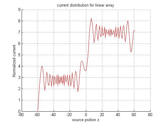

frn I tried code as you but am getting error vector dimennsions must be same
thanks
see this complete code here
clc
clear all;
close all;
%----------- Common Parameters for both approaches ------------
N = input('Enter the value of N --------> ');
N = round(N); % convert to integer
if(mod(N,2) == 0)
M = N/2;
else
M = (N-1)/2;
end

run for N=123, yeilds
hii frns we want to plot with respect to z not with -M:M .
ok but your z here is not correct, you must do some thing to z such as normalization or other thing
Added after 4 minutes:
you must see in your program that the number of points in AF is equals to -M:1:M
k but i don't know h to do normalisation.
if u know how to do normalisation please help me.

that means is it requir to modify our program?
thanks
yes

hii frn
I got output for our program . Modofication to that is normlised value.
thnks for your great help.
