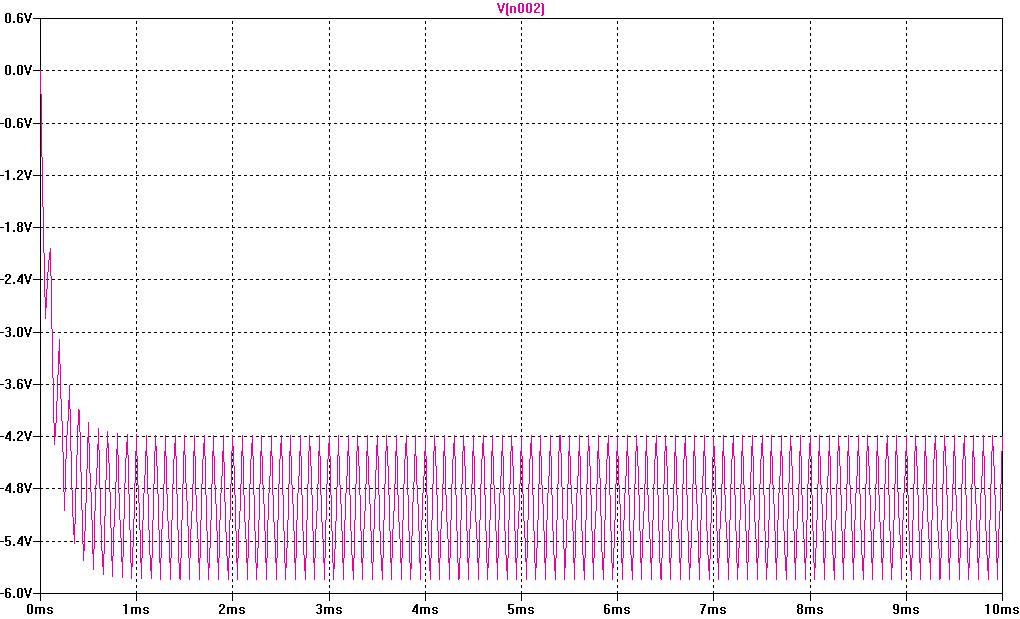

why we get this wave form???

Before I answer about your circuit, I would like you know that it is always good to insist undestanding something even in many ways, otherwise it is not science. :wink:
Edited:
Your input has a positive average voltage (have a look on its trace)... so the output should go down since the DC gain is negative... In LTpsice, Vinitial is practically the lower voltage (in your case it is better to let Vinitial -1, the opposite of Von =+1 since your duty cycle is 50%).
Edited:
I hope you know how to read the average and RMS values of a displayed waveform.
  • Draft1_1.zip
u gave intial condition to the capacitor 1.6V
on what bases??? who u calculated the value???
I cheated. I didn't calculate it I just looked at the maximum voltage of the steady ouput.
Edited:
But it can be calculated based on equation ( 10 ) above (R2=the actual R1). Note that the result is approximated since R3 is not relatively large (just 10 times R1).
