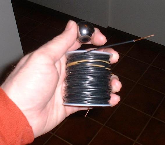

here is my coil
should i have more number of turns ? longer coil ? etc .............
My gut feeling is that you should have about 5-8 layers and ≈30 turns per layer ..
Regards,
IanP
longer coil means low discharge current ..so.. slow projectile speed 4 layer enough i think
