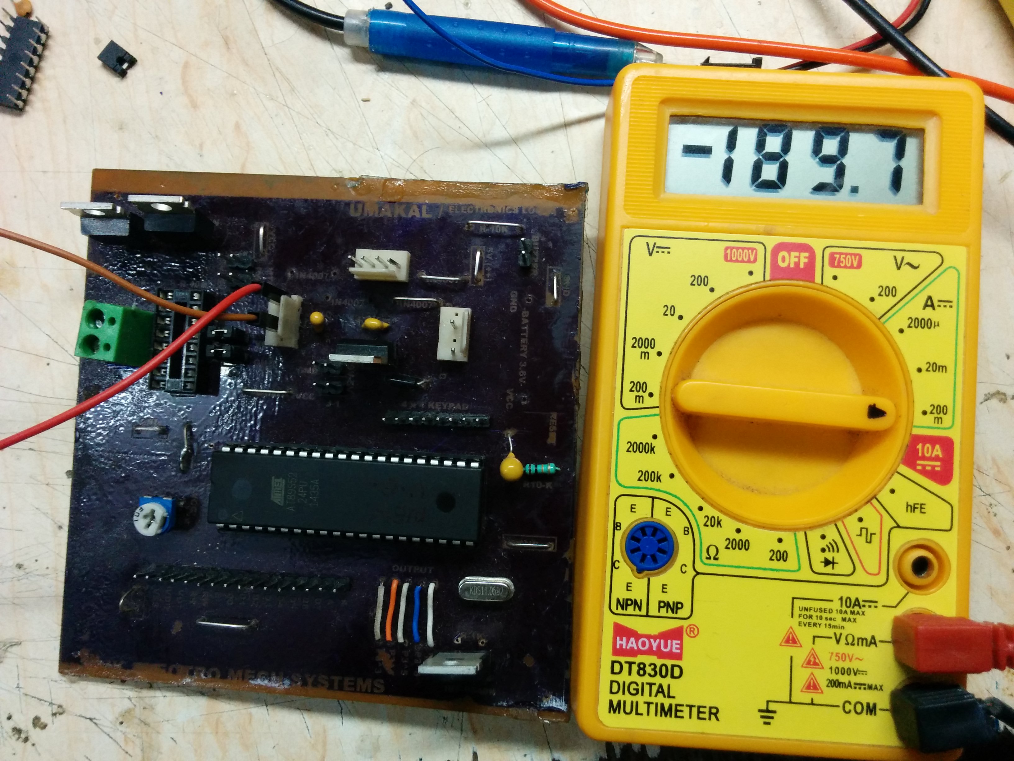

89s52 consumes more power
Do you have a known resistor of 200...300 ohms and validate measurement reading?

I still don´t trust the current measurement. Again, did you verify the current reading with a known resistor?. If not, please do this, because if the current reading is wrong we don´t need to discuss further.
For sure the XTAL frequency has influence on the current consumption. Read datasheet.
Klaus
Klaus
How can i verify with known resistor....
how can i do this
Just use Ohms law:
If you have a 4.8V voltage (are you sure it truely is 4.8V, or is this the "nominal value"?) and connect a 200 ohms resistor and your current meter in series, then:
R = U / I
I = U / R = 4.8V / 200Ohms = 24mA.
This should be the reading of your measurement tool (with some tolerance).
Klaus

yes i have done so...
but the result i get 72ma.
i have even added 33pf capacitor as per the datasheet.
So your current meter shows garbage.
We wasted a long time dicussing about "wrong values"!
Klaus

i am sending you the pic of 89S52 connected in my circuit and the amp reading.
is it my multimeter showing wrong values...????
but i have got the new one from eBay one month back....:-:)-:)-:)-(
if my multimeter is showing a wrong value.... then why my 7.4v 2200mah battery gets drained in 14-15 hours and 4.8v 800mah battery in 4-5 hours.
Step 1: Check resistor value with meter, is it 200 ohms? (write down the resistor value)
Step 2: Using battery connect resistor in series with it. (no other loads just the resistor across the battery), measure the voltage across the resistor, it should be around the 4.8 V as it's not loaded that heavily (write down this voltage)
Step 3: Connect the battery, resistor, and meter in series. What does the meter read is it the same as the value of Written_voltage/written_resistor?
If not it's reading the wrong value for the current.
You should be aware that the meter you are using has no protection on the current setting at all (just look that meter up on google). So if it's been subjected to current spikes it may have already been damaged.

Yes KlausST.... you were right.....
my multimeter was showing a wrong value.... so i brought a new one.... now i think am getting a proper value.....
so now i again need a small help from you....
when my microconroller gets to active mode it consumes 7.65mA and when its in IDLE mode it consumes only 1.48mA. so i want to set my microcontroller to idle mode when not in use....
so i wrote the code PCON |=0x01; which makes my 89s52 enter idle mode. but the issue is how to exit idle mode.... i am not aware of it... can you please help me with the code....
i want my micocontroller to exit idle mode when keypress is made. so can you help me in this case
