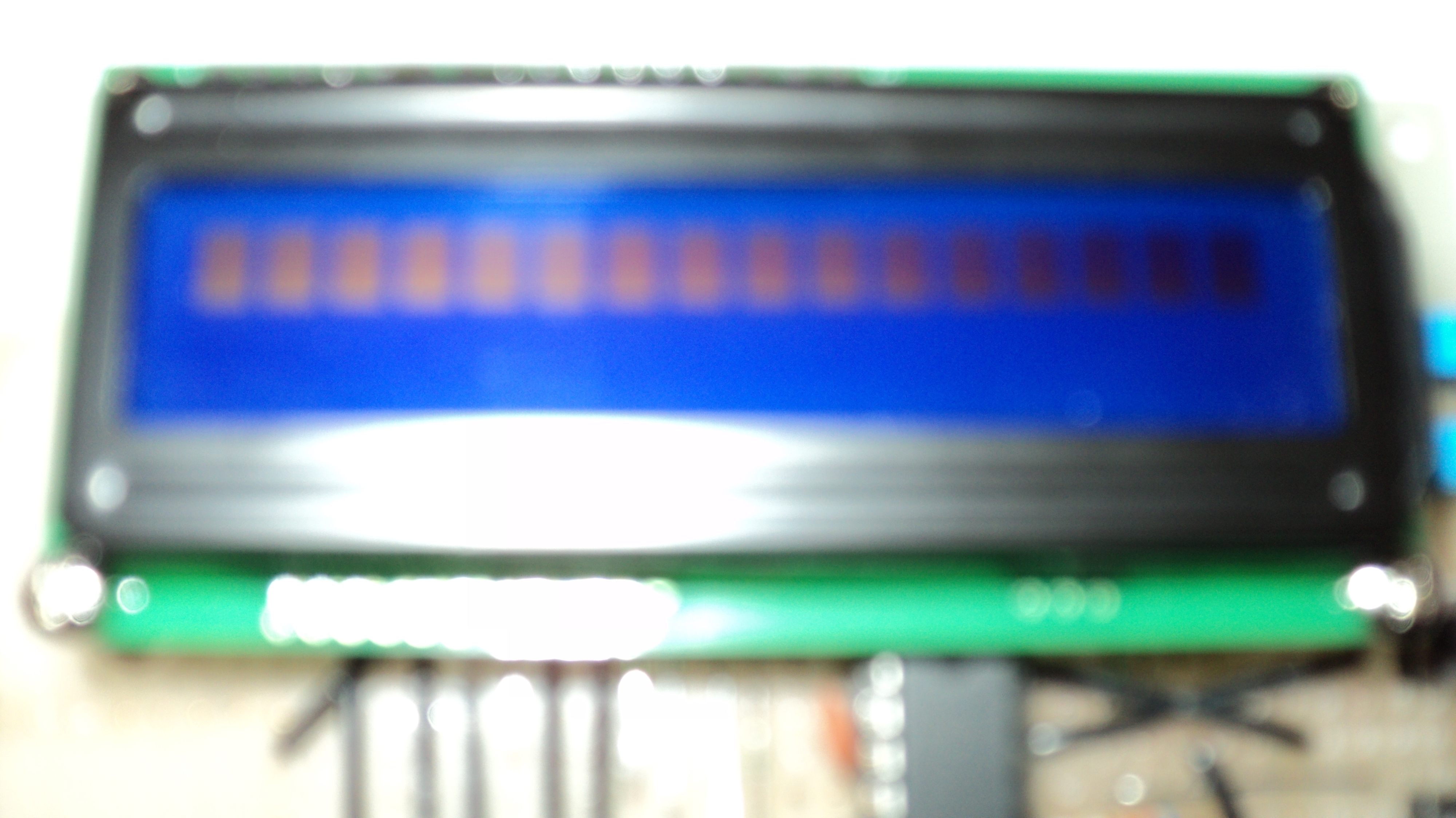

Hi Bkelciov, Thank you for the instant reply. The LCD is working but no Characters showing on to the display the image attached. what could be the problem you think?
I did made the made the ground circuit. i connected all the ground to 9v(-) including the display grounds. also both TLO82 Pin 4 and R4 5- to the 7660 Pin 5
Re: ESR Meter
replace R30 and R31 with 22Ko variable and adjust until is showing something. Check to have 5V on PIC. VDD to GND. JMP1 must be shorted. If is not working is meaning that the program is not working inside the PIC. The reasons can be:
- PIC is defective
- the programm is not writen correctly in PIC
- Cr1 ( the 20MHz crystal ) is not working. This must not be a filter !!! It must be a crystal quartz.
- C5 and C7 must be 22pF not nF
- C1 and C2 can be 4,7nF. I did use 4,7nF too.
- VD4 is 1N4148
- check the continuity of the circuit.
To see what you must see on display, try to use the "Real PIC Simulator" or "PIC simulator IDE".
Good Luck !

Thanks buddy well i used 22nf caps so i'm gonna replace that gonna try R30 & 31 with variable resistor. I'll let you know the results.
Would you please post me the right hex file (the one you used)because i tried the files i had with the simulator it didn't work
Thanks again

Hi Bkelciov, i triple checked everything and did replaced to 22pf caps(C5,C7) change another crystal reprogrammed a another PIC. Replaced VD4 diode into IN4148. Replaced 22k Variable resistor instead of R30 and R31 no luck.
Question what PIC you used? Mine is 16F873A .
Would you please send me the right HEX file so i can try again.
Thanks for your help pal.

Yeap, 16F873A is mine too.
Here is the hex:
