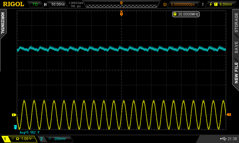

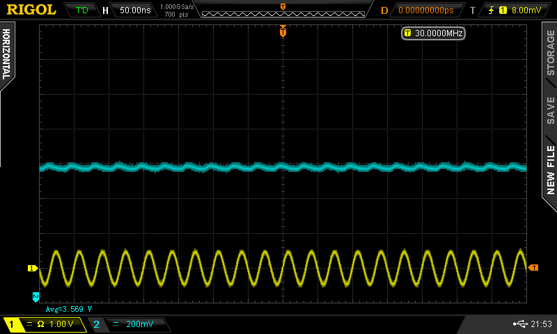

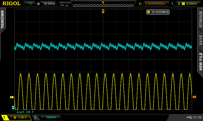

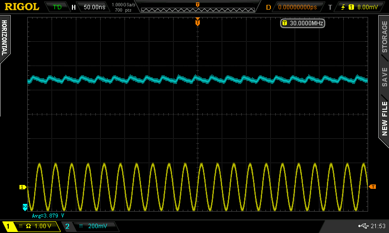

Hey @E-design,
First, thank you very much for your answer.
I built the circuit with the components that I had (like the pic) and I'm getting this reading on the scope (you can look at the pictures).
I get 5V+ half of the amplitude, can I get rid of the 5V? What will be the best way?
I would like to make it smoother, how can I do that?
What simulation program are you using?
Thanks,
Itay
And this is the schematic:
Try and spot the difference. Sim is with TINA.

Hey E-design,
I looked again and my schematic was wrong, I connected it like the top schematic in the picture.
I don't understand your issue. Don't construct this on a typical breadboard and expect good results.
Below are results from a circuit I quickly constructed on some copper clad pcb with two 1N5711 diodes. This is with a 50% divider for R2/3. The BAT54A matched diodes should give better results.
