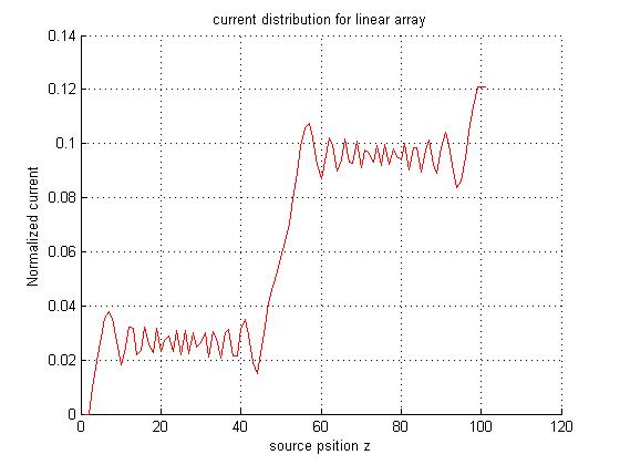

I require a code for current distribution of line source using woodward-lawson synthesis in matlab. That equation is in the 'Balanis' text book of antenna theory.

I will send you wat program we write for that can tell me how to plot graph for source & array? I am geeting near graph for source but no graph for array :cry:

for the array plot:
your problem that make the plot not appeared is the x-axis dimensioning at line 56. If you delete the x-axis in the plot commandt to be plot(abs(AF)/N, 'r'); then you will see your plot.
try it right now.
for N=100,
please tell me is this what you want to get?
no frn . our required plot is same as fig 7.6 (a) current distribution in pdf file

as i see, you are taking the positive values of m. In other words you ignor the -M values in line code number 41 {for ii = 1 : col
mm = m(ii);}
because u let m=-M:M; your calculations are for the positive values of m (from 1 to M only in line code 41 to 49).
for ii = 1 : col
mm = m(ii);
yy = cos_theta_m(mm, lambda, length, samples);
zz=z_m(mm,d,samples);
sum = sum + (bm(jj)*exp(-j*k*zz*yy));
jj = jj + 1;
AF(kk) = sum;
kk = kk + 1;
end
correct me if i am in wrong idea

now i complete my checking for the source. It is correct.
Added after 2 hours 1 minutes:
in fact,
i checked your array program. It is seem no problems in the program. Just do the following
%---------------------------- Lets plot the results -----------
figure; grid; hold on;
plot(-M:M, abs(AF), 'r');
xlabel('source psition z');
ylabel('Normalized current');
title('current distribution for linear array');
but in fact your program has no problems but why its results not like that in the book.
I suggest to do the calculations of the program by hand (take a small number of samples) and plot it.
