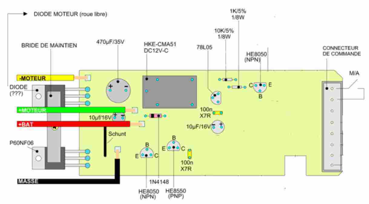

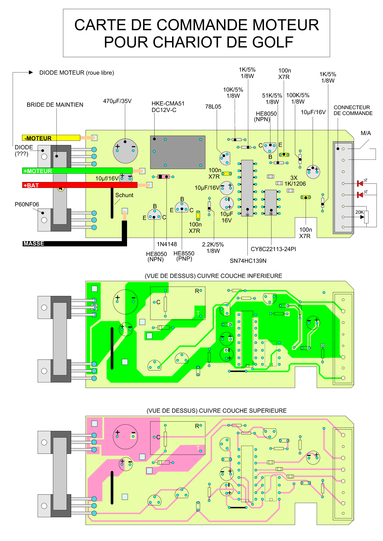

I found your board detail.
Thanks thats brilliant! try and do as you say, maybe a couple of days will let you know how it goes.
As you've most likely worked out i'm not to experienced on the diagnois side.
Output and drive circuit can be tested ok by shortening b and c of 8050 transistor right above the two ics near switch connector. Pin 9 of ic SN74HC139N is driving this transistor.It should be high to stop the motor.and lo to start motor.If voltage onthis pin is observed with meter, 5V means motor speed 0 .Speed will be inversly proportioal to voltage on the pin ie less votage means mor speed.Cause of fault seems to me is initially connecting battery with reverse polarity because there is no reverse battery protection. SN74HC139N is also driving indictors directly. This ic is most dougt full if 5V supply to it is ok between pin 8 and16.
Studied the board diagram only difference i can see is an extra condenser in between the verical resistor and third from top pin on connecter plug (right end). On this board pin 6 on chip goes to third outlet (lights) connecter through a resistor.

Do you think there is possibly a fault with the differences in design at right end of board where there is an extra condenser 10uF/16v on your plan, the best I can work out the terminal 6 from the chip on my board goes to 3rd pin on multi plug via a resistor.
I could try and design my board as your plan if I could work out where terminal at top right goes from 3rd pin.
maybe this might help
The extra condensor is just put there for filtering noise coming from pot wires. It is not critical, circuit will work without it

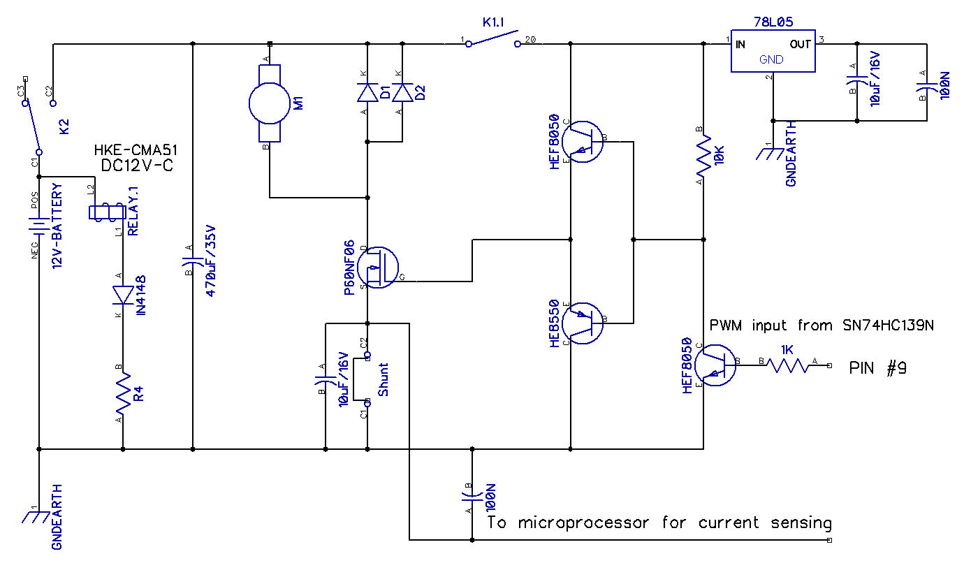

Speed controller circuit can be divided in 4 stages.
1. power supply
2. Output
3. Driver for output
4. Control
Power supply is ok ie 12V and 5V is ok.
Output stage consists power fet, diode is ok as tested.
Driver stage need more observation as
earlier
short B and C on S8050 switched on terminal 9 reads 11.6 volts and motor stops.
now
With B and C shorted together on transistor and switched on, voltage at 9 on chip = 0.75V motor running fast.
Lets see relevent components of driver and output stage
on board.
I drew a schematics for this portion.
Trouble shooting should be done in logical manner. From most suspected to least as numbered. For example if you suspect a bug in software of microcontroller and in the end a blown fuse is found.
Pull out one side of resistance marked with red dot. Now connect this end with 5v with a small wire, motor should stop runnig. If it does not short E and C of transistor on the other side of the resistor. Now if it does then change this transistor.
After that we 'll see about the controller.
Meanwhile also check the 5v supply to lower end of connector attached to one wire of pot and display LEDs.
