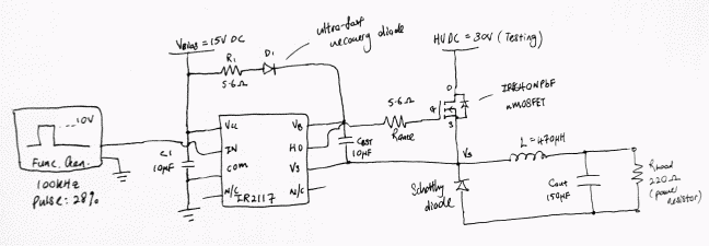

Also, if you're interested the attached image is my HV DC setup (albeit the HV now is 100V instead of 30V). I did post a thread on it: https://www.edaboard.com/threads/233047/

Yes, it will work as long as they can share a common ground. You could also use a 3-terminal 7812 since 28V is comfortably lower than the max input voltage rating of a 78xx regulator. Power dissipation in the regulator will be the same 0.64W you've already calculated. You could provide a small heatsink to keep it cool but that's not essential as it can easily deal with that level of dissipation without a heatsink.

And that reminds me of something else. If I may make a suggestion regarding your images: Take this latest one as an example. It's 1.40MB which is quite large, especially for those with slow connections, and it's not as clear as it could be. It can be much improved after you've downloaded it from your Blackberry. I did a few things to it and re-uploaded it here.The one on the left is 40.3KB and the smaller one on the right is 12.5KB. It took me a couple of minutes with Irfanview.
