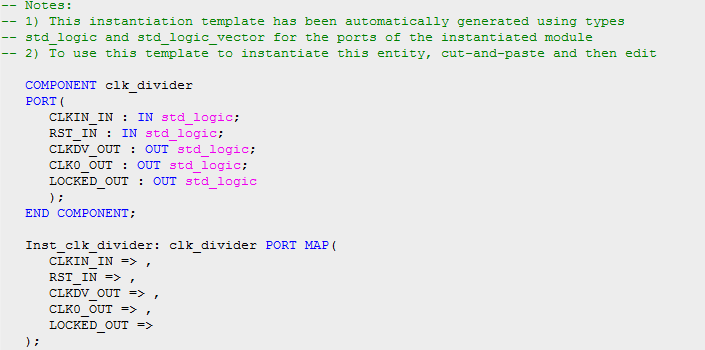

I want to divide the input clock frequency provided by my Spartan3-xc3s200 by 2. I used the DCM to do that.
I do not know why do they give me the CLK0 output since I do not want to use it anymore. I want to use the CLKDV output. Is it possible to leave it unconnected ?
Thanks in advance !
Just connect it to open, i.e. CLK0_OUT => open,
Reactions: CataM
    CataM
Thank you. By the way, I have connected a signal to LOCKED_OUT and the inverted signal to RST_IN, what do you think about that? Correct ? Incorrect ? I know in the datasheet they say that RST_IN should be activated on the transition from 1 to 0 of the LOCKED_OUT... but is it ok that way too ?
