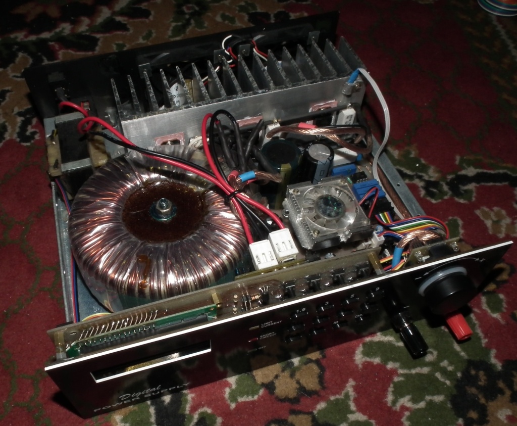

Workshop power supply 0-25V, 0-5A
This power supply convenient way to control was improved with a rotary regulator with encoder. A single movement of the knob corresponds to the „up”, „down” buttons on the keyboard, while longer and faster turning switches to higher or lower voltage threshold with an amplitude corresponding to the buttons on the keyboard. Implementation of this part of the power supply may cause some troble becuse of the difficulty with connecting it to the processor.
All boards of the power supply were home made. They were protected with a layer of lacquer. Paths passing to the other side were linked by a thin wire through the holes. Pins that do not connect the circuit were not soldered. It would be difficult to solder out eventual broken elements.
There was an additional module applied with processor Attiny2313, connected to the board with the power supply processor.
Both the front panel and the rear panel were made in the laminate using milling machine.

AVT-5161

Description of the system
Construction of the power supply is divided into
two parts. Diagram of the main part of the power supply
shown in Figure 1, while in Figure 2
diagram of the control system.
Power supply used in the construction of popu-
ne and readily available components, and most important-
importantly, their price is not high. The entire system
is powered by 200 watt transformer
with dual secondary winding
2x12 V voltage rectification provides a bridge
rectifier B1, capacitors C3 and C4 filter
output voltage. They have a large capacity,
which allows to minimize the output ripple
power when downloading large currents.
Capacitor C10 shorted to ground potential
brief surge of electricity grid.
Element acting as a controller in-
voltage is produced for years and well known
all LM723 circuit. It works in some
unusual configuration. For a voltage
output of less than 2 V Application-
no reduction in ground potential by feeding
a voltage of -5 V. The on-
voltage is quite sufficient for the materials
Skåne output voltage from zero.
Because of the reduction potential of the mass,
it was necessary to use a stabilizer
consisting of a resistor R11 and diode-Zene
ra D4. When idling power supply voltage
power would exceed the maximum permissible
dispersive value of 40 V, at which LM723 circuit

czono power transistors. Due to the restricted
cooling is possible to reduce deployment
also the heat sink. Measurement of the heat sink temperature
is implemented by a sensor LM35, which is
ADC0 input connected to the A / C
built-in microcontroller ATmega8.
Resolution of this amounts to a
of
C. Growth
temperatures above 40 ° C results in turning on
no fans via the transistor T4. O-
combining and after cooling
heat sink temperature of 38 ° C.
Also equipped with thermal protection
outs. Heat sink temperature rise above
60
of
C to disconnect circuits starting
Wych power by incorporating relay
PK2 (power supply output is connected to the Jan-
kow NC relay). The fact that peripheral disconnection
high output power is indicated
illumination of the LED D1. Protection
Heat turns off after cooling, the heatsink
at 50
of
C and voltage of the transistor
Power is also given to the output again
power supply. The temperature of the fan response
ditch, as well as thermal protection can
be changed freely by the user
wz range 0 .. 100 ° C. How to Set ZO-
will discuss later in this article.
Relay PK2 is also used
to manually disconnect the output circuit
by pressing the ON / OFF. It is certain
amenity for users in the case
to when handling cables are problems will not exist
potliwe.
The next block is the power supply system
current measurement and layout constraints cur-
tional. Measurement is achieved at
by measuring the voltage on the serial
resistor. The voltage drop on
resistor R12 is proportional to the sampling
ranego current. At a current of 10 mA drop
voltage will be at 1 mV, and at current
5 And this will be 500 mV. Voltage
you with the resistor 10 is reinforced
times by the amplifier U6 and served on the input
Path ADC1 A / D converter of the microcontroller.
Reinforced tension is also given
the inverting input of comparator U8A.
The second input of comparator given
is the voltage from the integrator circuit R14 C18.
As with voltage regulation, so
and in this, the principle of operation is identical.
Voltage in the system integrator is proportional to
proportional to the PWM signal, comparator-
U8A circuit compares the voltage so given the
U6 measuring amplifier with a voltage
the reference value of the course to be determined
PWM. If the output voltage increases,
U6 time rises above the threshold,
then the comparator output will U8A
voltage is close to 12 V, which caused
Duje triggering transistor limitations
contained in the current structure of the sys-
du LM723. This, in turn, will take over part of the current
the internal base of the transistor output
limiting the current to the value determined by
D / A. While actions to eliminate
present current system loses its
stabilization and is susceptible to excitation.
Before this type of phenomenon prevents condensation
tor connected between COMP end stabilization
Zator a ground loop.
If power consumption exceeds the set FOR IN-
armature C / A value, you will be well-
control transistor T2 in the system control-
ka. His leadership accompanied by an LED D2,
indicating activation of restriction and wiring
WEGO, which also results in instability
AC output voltage.
The proper functioning of the power supply
needed to block the power supply is still help-
nothing. It generates +12 V, +5 V
and -5 V. The voltage +12 V and -5 V is used,
important to power operational amplifiers.
Voltage 12 V power cooling fans.
+5 V power relays, as well as
other digital elements, such as micro-
LCD controller and the system con-
evaporator. This is the classical solution of the following-
pularnymi 78xx and 79xx stabilizers.
Requires more detail you eat-
June controller. As mentioned before
his principal, and also the only system
is the ATmega8 microcontroller. The driver fully
here as an interface between the system power supply
The CD data sheets and application notes elements
marked on the list of elements shown in red
________________________________________
Page 4
27
Playboy 12/2008
Digitally controlled power supply
and the user. For ports-mikrokontro
Lera is accompanied by a 2x16 LCD display, the
which displays the output voltage
ściowego, current and temperature of the heatsink.
Potentiometer P1 sets the counter-
hundred of the display. For the microcontroller is
Also included in the keyboard matrix. To
eight buttons are assigned to permanent it is worth-
COMPONENTS output voltages of 1.5 V, 3 V, 5 V, 9 V,
12 V, 14.5 V, 18 V and 24 V. The ON / OFF,
As mentioned earlier, is used to detach-
and fluctuations of power outlets.
UP and DOWN buttons to set the value of
voltage and current limit, as well
temperature independent activation of fans
and thermal protection. Press
MODE sets the operating mode power supply - the sta-
bilizacją voltage or current limit.
The system also has a signaling circuit
AC output circuit. The role of signaling
Zator fully herein LED D3 and pie-generator
ZO, controlled from the output of the microcontroller PB4.
Microcontroller based on the measured value,
values of output voltage and current are calculated
the load resistance. With the state short-circuit
Photos taken with the accompanying resistance
less than 0.1 V.
Installation and commissioning
The system must be assembled on the plates of two-
sided with metallization of holes, repre-
down in Figure 3 and 4. We start from wlu-
lation, the smallest elements, we end
the largest. During installation you need Pay-
Now these close attention to the correct position
individual elements, because the later
desoldering them from the plate may be bilateral
cause problems especially the less experi-
is ready for electronic engineers.
Installation is best to start from the plate for seeking
Links. Two stabilizers with heat sinks mon-
tujemy at the end. Prior to soldering
stabilizers must first fix the
heatsinks, and then solder them into the plate.
When properly assembled, the system shall be
screwed into the radiator Utilising the bridge B1-
ture using the four holes in the plate and bearing in mind
by lubricated paste bridge to facilitate
heat dissipation. The heat sink is necessary
ny after prolonged charging adapter
large currents.
Finally, we begin to mount tran-
zystorów power. Screw them to the ra-
diatora using thermal paste.
If the radiator is not isolated from
the power supply, use a mi-
tional insulating washers under the transistors.
Transistors connected to the connector plate T5
power according to the scheme. To sink
you also attach a temperature sensor.
Next, mount the plate
serving as the front panel. Earlier
You can prepare a face plate
housing, cutting and drilling holes in it.
The plates are dimensioned for the metal
housing type T267. LEDs and dis-
LCD conn are soldered in the correct
Figure 4 Assembly diagram of the control device
Figure 3 Diagram of the main assembly of the power supply
Page 5
28
Playboy 12/2008
distance from the plate, so that were on
par with the front panel or enclosure
protrude slightly beyond it. Before
the solder plate can be screwed
controller to the previously prepared
front panel using the sleeve
distance of 12 mm. Then, the mouth-
flagellum LEDs and display in a suitable off-
tance from the plate and solder them. Proceeding
In this way we will make sure that
soldered components will fit perfectly into
the front of the plate holes. Connectors Z1 ...
Z3 and the microcontroller must stand
printing solder side - the opposite
side buttons. When properly assembled
waniu plates a piece them together
10-band tight-wire connectors
10pin IDC. Plates used to connect the socket
Z8 on the power supply board and a socket on the board Z2
driver. Connector on the controller board Z3
there should be +5 V supply voltage
Z5 available on the connector of the power supply.
After correct assembly and sub-system
connecting the transformer TST 2 * 12 V/200 W
Connector Z1, Z2 and transformer TS25/025 to
terminals Z3, Z4, you are ready to start-
present supply.
If you turn on the power dis-
knowledged do not receive any writing, you
adjust the contrast. Use the potentiometer
P1. Before further adjustment we make sure that
products are all operating voltages
and check whether they have adequate
value. Now, set the voltage of the non-
balanced amplifier U7. In this
Switch off the 10-wire ribbon cable from the plate for-
athlete and short-circuiting pin connector 8 Z8 for the masses.
By adjusting the potentiometer P1 is set
voltage of 0 V at the output of the amplifier,
with the smallest measuring range-
measure it we have. Then
connect the tape again and set
pressing the power supply output voltage with-
button for example, 12V. At the output of amplifier U7
should occur 1.2 V. If the voltage
slightly deviates from this value, you can re-
not make a correction and set the voltage to-
exactly 1.2 V. Next, make-
We adjust the output voltage divider.
Attach a voltmeter to the terminals starting
Wych power supply and a potentiometer
P3 is set equal to the voltage of 12 V. You can
still measure voltage at the terminals 4
and 5 of U5, it should be 1.2 V.
After setting the voltage to be regulated,
wac indication of the voltmeter. Regulatory doko-
blue prints by turning the potentiometer P4, so that the
display was indicated value of 12 V.
If using the buttons will be amended
NIACE the output voltage, the indi-
Solutions voltmeter should now agree
the actual value of the output-voltage
it. When changing the output voltage on-
is also to check the working
Relay PK1, which is responsible for offenses
necting power-transformer windings
it. At voltages above 12.5 V should
be audible relay operation. If
the relay will switch not properly
windings, it is not possible to obtain
full scale output voltage
power supply.
To adjust the measurement block still remained
current and current limit. Adjustment
This is done by idling for seeking
knowledged. With potentiometer P2 set-
We zero-voltage imbalance
the amp U6. Then adjust the
strengthening of the amplifier. For this purpose, accom-
czamy to power a small load, such as
12 V/21 W bulb, and when you press
MODE is set by using the UP
and DOWN current limit of 3 A. The
said lamp power supply load
flowing current should have a value of about
1.75 A. Then measure the voltage on the resistive
Storz measuring R12, amounted, it should
sic 175 mV. Now, with potentiometer
P5 set the output voltage increases,
U6 time. It has to have a value of 10-fold greater-
measured on the ordinal of the measuring resistor
dim, or 1.75 V. After this display
ammeter should display
match the actual value flowing
the current. You should now see limited operation
niczenia current. Disconnect the power from
light bulb by pressing the ON / OFF and reduced
szamy current limit to the value of 1 A.
After restoring the voltage should
be signaled by activation of limitations
lighting of the LED current through D2.
Disconnect the bulb from the power supply now and for
we close with a piece of wire terminals
output voltage. Should a short circuit condition
be indicated by intermittent signals
sound and blinking LED D3.
It remains to check the correctness
connected to the fan control
Z7 and Z9 connectors, as well as action-secured
the thermal baking. For this purpose, load-
We see the current power supply and tempera-
turn the heat sink is shown on the display.
After reaching the heat sink temperature
40
of
C should be attached fans.
Built-in thermostat has a two-step hi-
sterezę's fixed, so the fans
should be cooled off after the radio-
tor to a temperature of 38
of
C. To check
thermal effects should be
increase the temperature to
60
of
C. If the load at a given temperature
round does not rise to that value, it should be
more power to charge. After reaching the
said temperatures should enable
The security and be heard tripping
relay to shut off the power supply
the connected system. Should light up
the diode D1. Thermal protection
off automatically after cooling ra-
diatora at 50
of
C.
Support for AC
Supports power supply is very simple and in-
tuicyjna. MODE button to switch
setting mode power supply voltage or limited
niczenia current. When you turn on power
automatically enters the setting mode
voltage, which can adjust the
are assigned to them on a fixed-
I voltage or DOWN buttons
and UP. In this mode, the display shows-
important is the actual output voltage, tem-
temperature of the heat sink and the value of the flowing cur-
