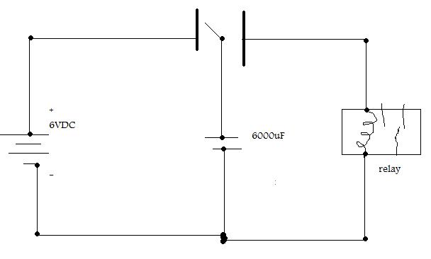

I had thought about a voltage divider or just decreasing the voltage to 3v but what i want is to keep the relay on for the longest time i can with a 6000uF cap, what i mean is "how long can i keep the relay on with a 6000uF cap, 6VDC, assorted resistors, and some switches?" To be honest this is for a Science project and one of the limitations is no diodes ( ). This is my circuit so far...
Another question is how can i calculate what size resistor to use for maximum time.
EDIT:: at some point the relay needs to turn off, thats why im using capacitors
To get the maximum on-time, you need to overcome the turn-on voltage, which on the spec sheet is about 1.05V for that part. Additionally, you'll want to discharge as little energy as possible (so your cap voltage stays up, longer). The drop-out voltage on that part is pretty low, too... I think I read around 0.15V??? So the relay will stay closed until that threshold is hit for the coil voltage.
Having a higher battery voltage will mean a bigger resistor to keep from blowing up the relay coil, which means it will be burning off power too. It sounds like you'll have to strike a balance of max voltage, extra energy lost to the resistor, and current draw rate. I'd start with a simulation or write down the fundamental equations and try several implementations to find the best balance.
You could set up a simple transient analysis in SPICE to run the numbers and try some values. I know LTSPICE is freeware, maybe you could start there, rather solving the RC charge/discharge equations by hand (or use Excel)... lots of options to experiment with values.
Since you aren't concerned about the turn-off transient (going until the supply voltage dies), the diode is a moot point.

So would you for sure recomend just lowering the voltage to 3v (just 2 AA batteries) so i dont have to worry about another resistor?
Then my only numbers are
1. The voltage it takes to turn on (1.05V)
2. The voltage it must drop to to turn off (.15v)
3. The current it takes to stay on (133.3mA)
4. The resistance of the coil itself (11.3Ω)
5. Any additional resistance to fine tune it (XΩ)
6. Starting Voltage (Vs = 3v)
7. Total Capacitence (6000uF) -semiadjustable
In order for it to run it must
1. Start above 1.05v - Starts at 3 when t=0
2a. Stay above .15v - (0 = (Vs*e^(-t/RC))-Vc) Vc = .15 How long it takes the capacitor to discharge to .15v will be determined by the total resistance (R = 11.3Ω + XΩ)
2b. Stay above 133.3mA - (0 = (Vs/R)e^(-t/RC))-I) I = .1333
In order to find how many seconds it stays on i will graph 2a and 2b and when either one hits 0 thats how many time constants it will run, number of timeconstants * timeconstant = time in seconds
Only 2 vars are R and t.
What happens if i solve the system? -Ill try it now.

I would leave no stone unturned in your quest for maximum on-time. A slightly higher voltage may be a trade-off you could play against energy lost in your series voltage-limiting resistor.
For a cap, energy stored (in Joules)... U = 0.5*C*V^2. So, if you double the voltage, your stored energy goes up by the square (2^2 = 4x). Quick physics info on caps
In the end, you are trying to make the best use of your stored energy. You have a store of X, and a bleed off of Y per second. X and Y are dependent upon your initial voltage, size of the cap, and how quickly you remove that energy from the storage device.
If the equations get too ugly, you could plug them into Excel and use that to do some of the calculations, then look at some specific measurements, like you identified before... voltage cut-out limits, and when they are reached.
You are on the right path, now that you know the "knobs" you can adjust on this system (voltage, resistance). Now you start making permutations and see if you can find a trend... then track it to the peak value. A very cool problem... if I had the time, I'd be working it right along with you!
