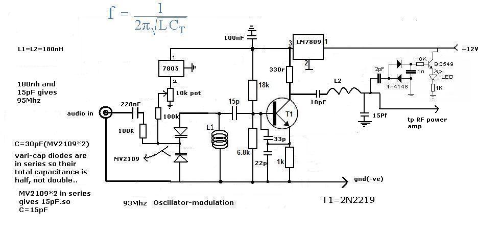

1)please tell me does this oscillator work
2)i think the oscillator tank in from MV2109 to the L1 inductor! am i right!
3)which type of oscillator is this!
HOW IS THE STABILITY OF THE OSCILLATOR!
PLEASE HELP
AND IS THE CALCULATION OF THE FREQUENCY IS RIGHT!
The vari-cap diodes are in series so their total capacitance is half, not double.
You will never know the tuned frequency because you didn't include stray capacitance and you don't know how much is the stray capacitance.

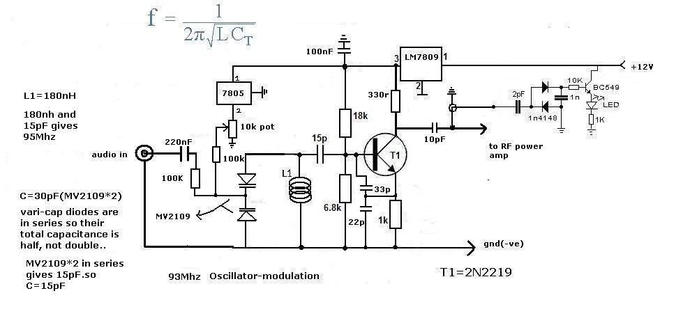

I think the output level from the emitter is very low. The output level from the collector when it had a load resistor was much higher.
The previous version with the output from the collector could drive an RF amplifier better so that you would get into more trouble for causing communications and TV interference.
how do u calculate the stray capacitance!
if there is a stray capacitance can u guess how much it would it be!
Added after 25 minutes:
here i have changed as u said check it out!
Each piece of wire has stray capacitance. It will take weeks for you to calculate it all.
Then you will need to also calculate all the stray inductances of every piece of wire.
If you built 20 of these simple transmitters then maybe you could guess about the stray capacitance and inductance.
Simply build it and adjust the capacitance until it works properly.

You do not know how to subtract numbers.
Each Vari-cap diode is 30pF. When they are in series their total capacitance is half the value of one. So their total capacitance is 15pf, not 30pf.

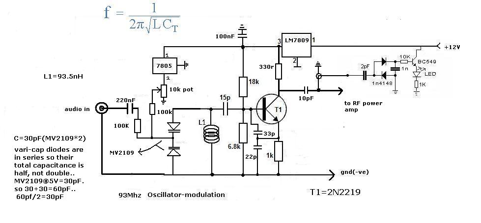

ya sorry the value of the two MV2109 in series is 15pF
and please tell me should the 15pF in series connected to the base of the 2N2219 should also be added to calculate the frequency!
Added after 49 seconds:

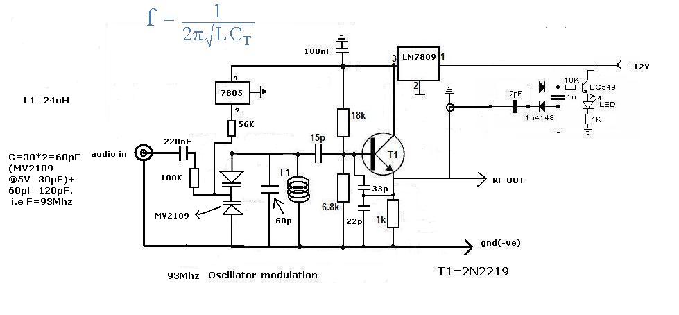

It doesn't matter because you did not include the capacitances of the transistor and of the stray capacitances.
Why are you using an old 2N2219 power transistor when the power in this simple circuit is very low?

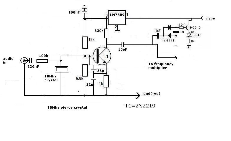

Now you have an AM transmitter if the oscillator works.
The Pierce crystal oscillators that I have seen use an inverting transistor or FET and some phase-shifting capacitors.
