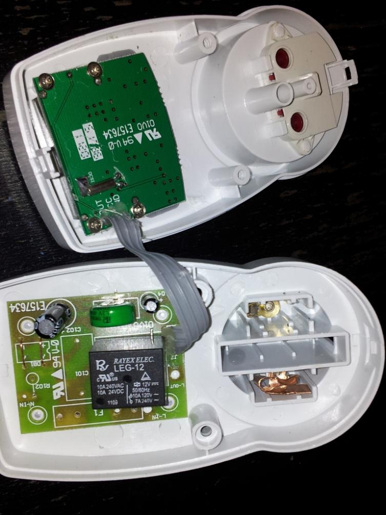

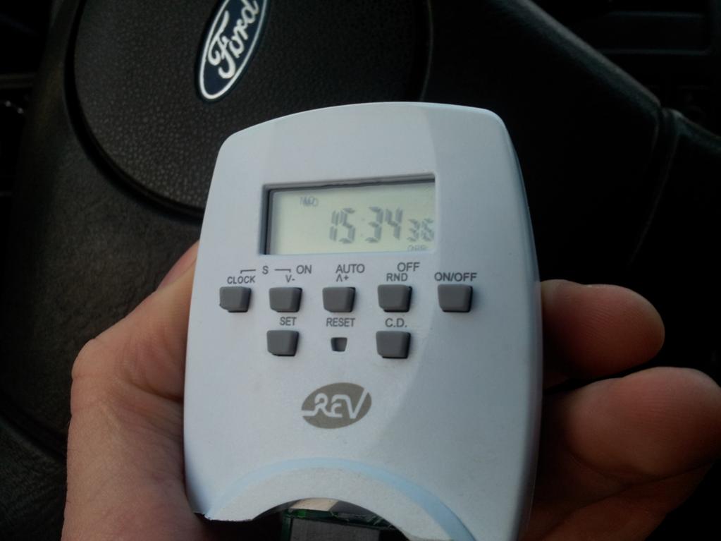

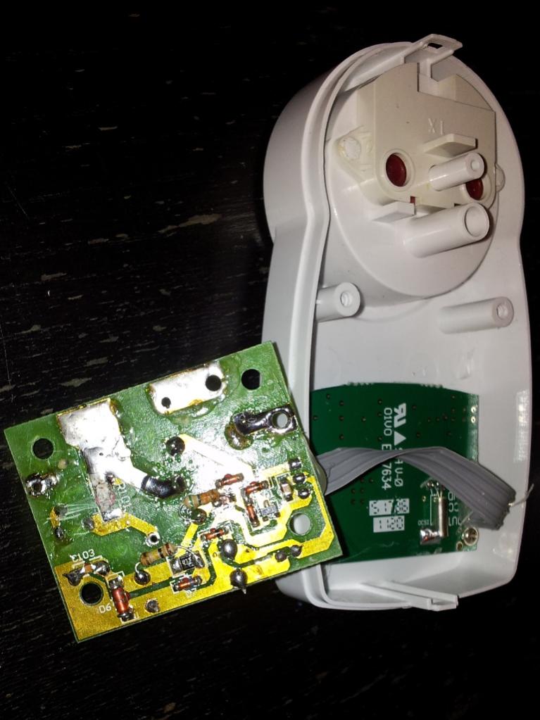

Control:
Control was carried out by processing a factory programmer - changing the 24V relay to 12V and adding 2 resistors. An old socket RJ45 was used as the output interface of the programmer. The programmer is equipped with its own battery, so that it can be disconnected and taken away. Main functions of the programmer are: setting the start and stop time (it has 20 modes). There is also Timer which is extremely useful when you want to start the stove for eg 15 minutes by one click.
