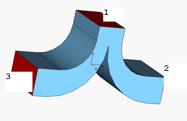

do you know, how can I do 3dB coupler? I have waveguide R120 (WR75) - 9.8-15 GHz.
For example this:
but I have not the theory. Or other solutions?
Can you help me?
Thank!
EDIT:
Do you know, how can I design branch-line coupler in waveguide?
U can try:
- a "T" divider (if u don't need low coupling between output ports)
- magic "T" (u have a further freedom degree)
- a branchline (4 ports, advantages on isolation between putput ports and on reflection at the input port)
- Wilkinson divider (similar to the branchline but more compact)
U should find everything on the most common books.
Let me say if it helps.
Regards,
Lupin

"T"- there is problem with S11.... and I need matching all port, "T" is have not matching of 2 port.
I think, that the coupler is better solution for me, divider is not good.

If you do not understand me, see the picture:
Divider
and "S" parameter is:
S
S21 and S31 - are good - 3 dB, S11 < -25dB - good. But S22 and S33 is very bad.....
