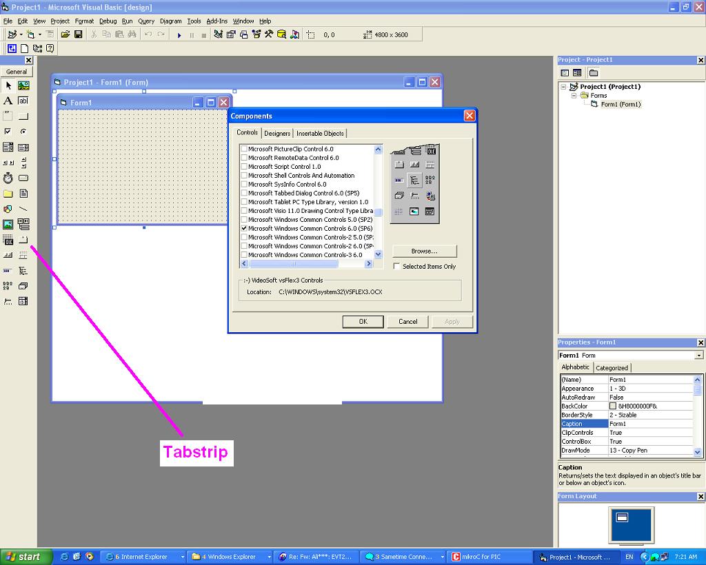

Yes its a plug in. Right click onto the toolbox--> goto Components and check the Microsoft Windows Common Controls 6.
Next put the tabstrip contol on the form just like any control. Right click on it to play with the property pages.
Hope this helps a bit.

You can also use the SSTAB component.
