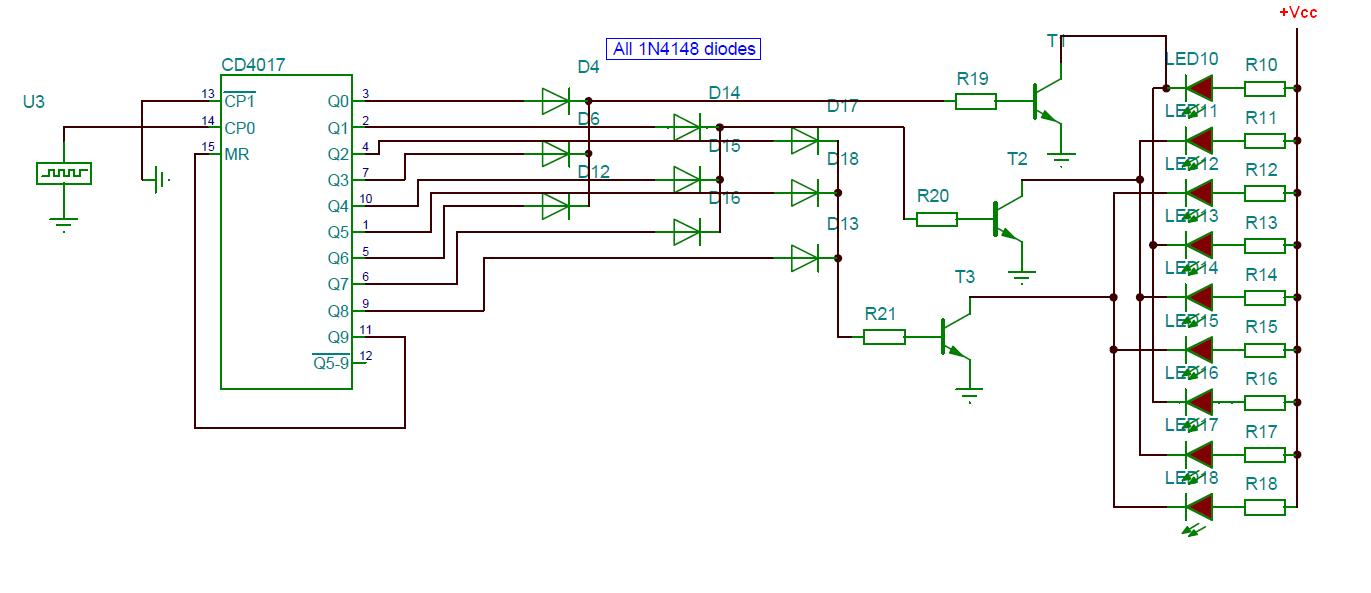

Hello. Thank you for your attention. I would like to work four outputs at a time. 0,2,4,6 and 1,3,5,7 and repeat the process.

For the CD4017 I think it's not possible to get that sequence unless you are using separate decoder and counter circuits.

One idea to use some diodes to obtain a 9 LED chaser circuit. :-D
Sequences for this combination:
1. LED1, LED4, LED7 = ON
2. LED2, LED5, LED8 = ON
3. LED3, LED6, LED9 = ON
and so on

Thank you so much! A really appreciate!
