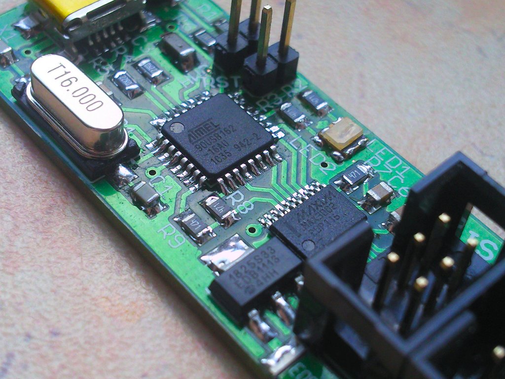

USBTiny-MKII SLIM programmer supports all the microcontrollers: Attiny, Atmega and Xmega. It has three programming interfaces: ISP, PDI and TPI. It directly cooperates with AvrStudio or AvrDude. A little plate is equipped with double-direction tension translator for all interfaces, cooperating from 1,2V, a jumper that allows to power the target system 5V or 3,3V (LDO 3,3V stabilizer) and signaling LEDs. The main element of the system is AT90USB162 controller with a hardware USB interface, so that the programming speed is very high.
The programmer:

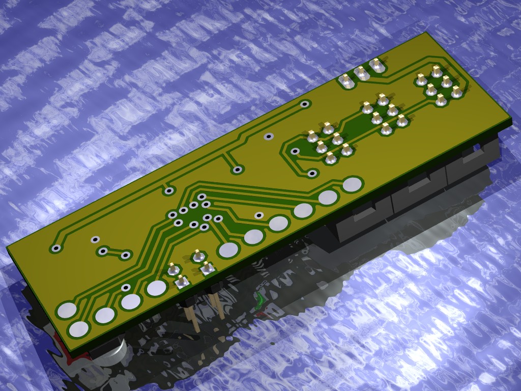

The system is built on base of another project (LINK), the programmer modeled on USBTiny-MKII **broken link removed** and USBTiny MKII PL (LINK). Instead of original tension translator GTL2003, MAX3002 was used, because it is easier available. The change requires a small code modification.

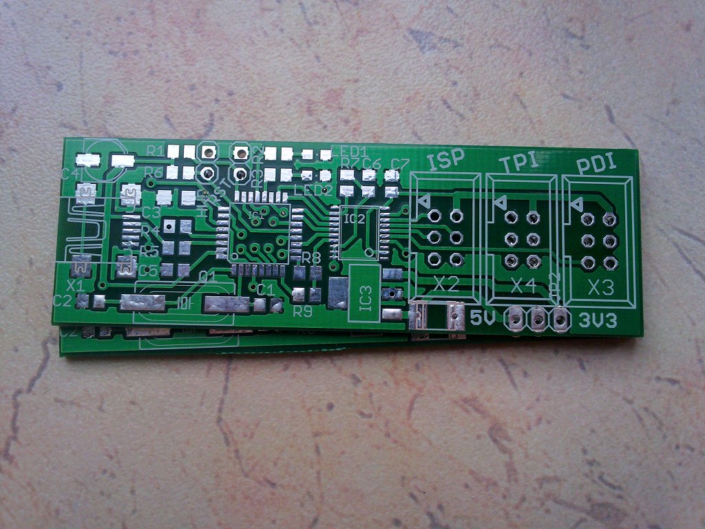

The programmer has three bath connectors 6pin to handle the three protocols: ISP, PDI and TPI.
They allow to program all available Atmega, Attiny and Xmega systems. The plate looks complicated and crowded, but it can be made in domestic conditions. The vias needed for the programmer, can be made of a wire. Vias under at90usb162 system move out the remaining pins to the bottom of the plate, where sizeable pads are – so the system can be used as a testing plate for different programs using USB hardware. Changing the program is really simple, because it is done by a fast USB bootloader and the free tool from Atmel – FLIP .
Under the bath sockets there is a jumper to choose the tension used to power the target system. Positioning of 1 and 2 pin – tension of 5V. Positioning of 2 and 3 – tension of 3,3V. In order to decrease the tension, a line stabilizer LDO type MCP1825S-3302ED was used. Another stabilizer can be soldered, it only has to be vertically according, like LF33. The jumper completely removed wouldn't give any tension to the target program, so it is for the secondary side of the tension translator, which has to have the power supply. In this case the power supplying tension has to be lead by tape from the target system.
