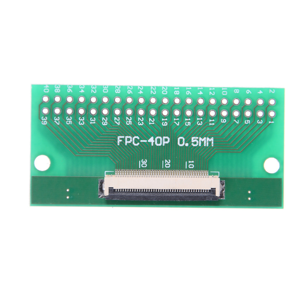

I would like to reuse a **broken link removed** originally part of a Samsung DVD player. My goal is to eventually be able to connect it via USB to a Raspberry Pi.
Although this DVD reader is quite similar to a "standard" IDE DVD reader commonly used in desktop PCs for a long time, connectors are different: IDE interface is managed by a 40-pin ZIF connector and power is supplied in the original circuit from the motherboard of the DVD player via a mini-Molex connector.
The section here attached (PDF document) of the original schematics of the DVD player describes the interface more in detail (I believe the relevant part is only the circuit on the left named DVDCON1 LOADER).
I tried the following - **broken link removed** (same that the picture at the link, except that I have a 40-pin female IDE connector soldered to it) with an IDE to USB convertor. Power is supplied from original power supply via a custom connector.
But it doesn't get recognised by my RPi 4B rev.1.1 (running up to date Raspbian version) - no mention of it in dmesg when plugging it.
Multimeter measurement shows stable power supply (12V fed to the convertor, which in turns feeds 12V and 5V to the drive and 3.3V to the IDE PCB interface) and i can hear/feel the DVD reader running, so I believe the issue is only related to the IDE interface.
I tested the IDE to USB convertor after purchase with a standard IDE device and it was working fine. Similarly, I tested continuity of the contacts of the ZIF-to-IDE adaptor with success and this is a simple piece of PCB without component, so this should not be the issue.
Now, I believe it is somehow due to some differences between the standard IDE interface above-mentioned convertor is made for and the actual IDE interface of my DVD drive.
In particular, there are some resistors in the PDF's schematics that I had not taken into account, not being so sure on how to do it. Additionally, I made some measurements on the pins that you can find in below tables (odd pins in the table on the left, even pins on the left) while the DVD drive was connected and running. They show what the given should be as per IDE standards (specified name & description), what they should be as per the schematics of the original DVD player (cf. attached PDF document), Voltage measurement (always using pin #40, supposed to be GND, as one of the two ends), and Continuity test (when everything was turned off) with pin #40 to check whether GND pins were those expected (showing many surprises).

It may simply be incompatible of course but you could try this:
connect pin 19 to 0V, I think it normally grounds the chassis but might have to be 0V.
ATA doesn't usually use pin 32 but you could try adding a pull-up to 3.3V in case it expects 8-bit transfers.
Check your USB adapter itself is recognized by typing 'lsusb' at a terminal prompt, it should show up on the list.
Brian.
betwixt, from the new table above, I now see that pin 19 is already connected to Ground (I assume that is what you meant when mentioning 0V).
As for pin 32, manufacturer's schematics says it is not connected. I measure -0,54V on it (same value as for several other pins: 1, 20, 21, 23, 25, 27, 29, 32 and 39), but I am not able to tell what it could mean - connected? not connected?
Just tried something more - I connected the female IDE connector to the male IDE connector with jumper cables in order to have 7 pins (#1, 27, 29, 39, 34 and 21, 31) going through a breadboard where i added the resistors as per the schematics and connected them back to the male IDE connector. One end of the first 5 resistors is connected to a 3,3V source (provided by a GPIO of the RPi set on "high") whereas one end of the 2 other resistors are connected to Ground (pin #40 which thus also go though the breadboard).
When powering up everything, the device is not recognized. The LED "IDE/BUSY" does not light up at all this time.
Any suggestion?

There can be no negative voltages on any pins when only a positive supply is present and all the lines are pulled-up to that supply so any negatives you see are not real. They are most likely to be 0V but the other probe is at a slightly higher potential above 0V. It can happen quite easily because current running through the resistance of wires causes a slight voltage drop.
Again, you are using a drive that may not implement the full ATA command set. Control isn't directly from the cable, there is an on-board processor that interprets the commands sent over the data lines and from there operates the stepper and spindle motor controllers. In a general purpose drive the commands are standardized so they can be fitted into any machine but when a drive is specific to one device, such as a particular model of DVD player, it does not need to implement all the commands and may even use a different command set altogether. It isn't safe to assume it even follows the standard PATA pin outs. On the DVD player main board the drive will connect to a dedicated VLSI device which is also programmable, that means the manufacturer can do whatever they want to make then talk to each other but they have no need to follow any standard.
Have you tried it with a 'normal' PATA interfaced DVD drive to see if that works?

Indeed the drive connects to the VLSI named "MIC1". On the schematics here attached, we can see references to ATAPI bottom-left and right-top. Names of the lines do not all exactly match the one of the previous schematics, but whatever. Just to be sure I understand properly - the magics being done inside this MIC1 to interface the drive cannot be guessed from this new schematics ? Would it be theoretically possible for me to pursue the exercise and reverse-engineer this non-standard interface in order to reproduce it and eventually bridge the drive to my RPi ? I believe this would be beyond my abilities and would require more elaborated material than I have, but would you be able to describe me very broadly the method for education purpose?
I did try to connect my IDE/USB convertor to a "standard " PATA DVD drive with IDE and MOLEX connectors, and the latter got successfully recognised by the RPi. No ZIF adaptor or additional resistors required in this case of course.
