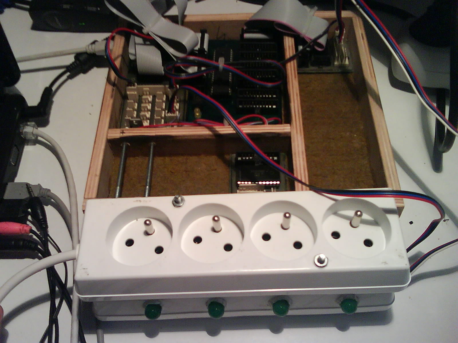

This is a project of USB controller with 64 individual outputs. The device supports software written in C++/Cli. Program can be controlled by each of 8 bytes in 8 channels manually by checking the checkbox or in case for connected C/A converter you can smoothly regulate the binary value on the channel using slider. Scripts can be additionally written. It allows you to switch on the light at a given time, or switching on and off the light every few seconds.

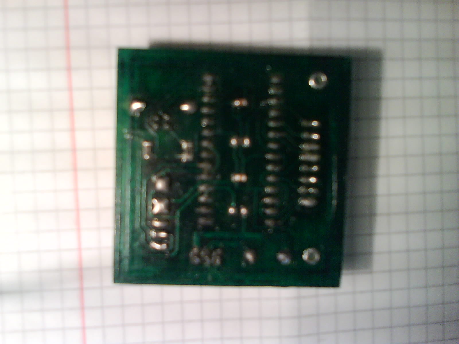

Module communicates with a computer:
Easy communication is provided by FT245RL.
The processed data are transmitted in parallel to the multiplexer.
The system is based on Atmega8535 microcontroller.
Separate data are passed to the registers.
A bar was designed for executive modules, which allows you to control up to 4 devices with 240W maximum load.
The supply module provides power for the device:
Before connecting cables:
And with cables:
Connected to voltage:
