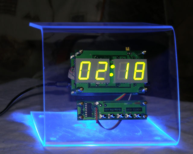

The main elements of the alarm clock are Atmega8 and PCF8583, which is battery maintained when there is no voltage. The clock has an alarm with a possibility to enter settings from your own keyboard, from IR remote control (SONY, JVC or RC5). It can be also connected with a PC through RS232. Not only you can set the clock and alarms form your PC program, but also sunchronize time with Internet. All that means that this clock is really exact. It is very important for selecting capacitor with PCF.
Morning snooze can be turned on without going to the clock because of the remote control, which can always be in the palm of your hand, even in your bed. Remote control can be also used for adjustment of the display or housing brightness.
The housing was made of a bent piece of plexiglass. It is backlit by RGB diode, what provides several modes of backlight – so you can change colour of the housing or enable a program which makes colours smoothly change, which gives a very interesting effect.
