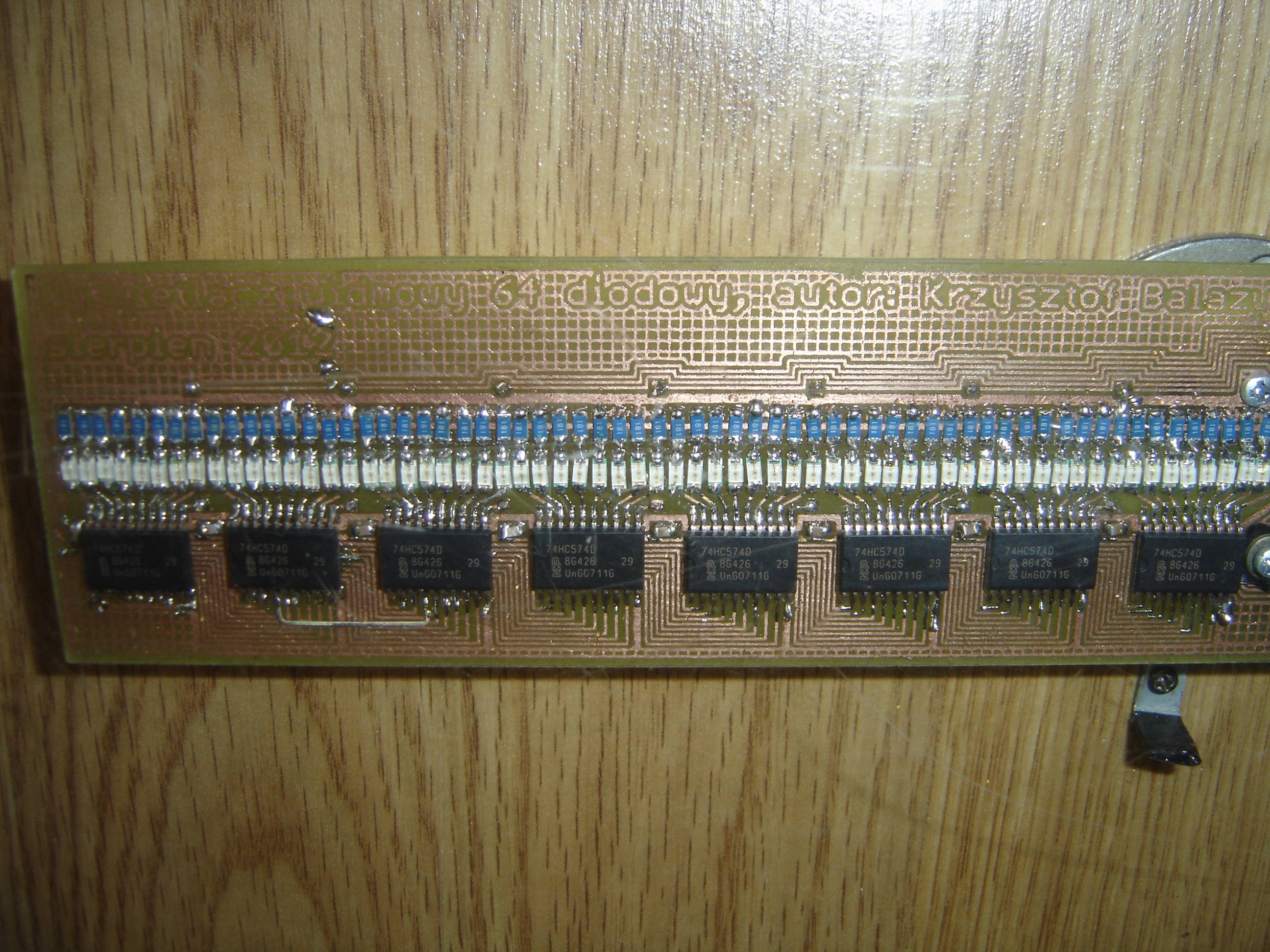

As it was mentioned before, this version is based on SMD diodes which are very bright and the angle of bright is almost 180”. Due to their size, the gaps between diodes were reduced to the minimum, what, when all diodes are lit, gives the impression of the whole circle lit, not the concentric circles.
Latches instead of shift registers:
Another idea is diode control by means of latches 574. All the latches have common inputs and the data is latched in portions of 8 bits (not of 1, as while using shift register 595). Their clock slopes are controlled by shift register 595. Such connection of diodes engages only 10 microcontroller outputs, even when you want to connect more diodes, the number of pins remains the same. If the diode control used shift registers 595, setting the state on all diodes would require 64 shifts, so in the way it actually is performed, the number of commands is limited.
Diodes and their connection:
Diode current is limited by resistors 180R, what gives about 16mA. If all the diodes were lit, they would take 8 * 16 = 128mA, what could damage it (maximum allowable total current 80mA). The combination of half of the diodes in one side and the other half in the other side within a single latch makes that for all lit diodes 64mA flows from the latch through VCC, and the other 64mA flows through the GND.

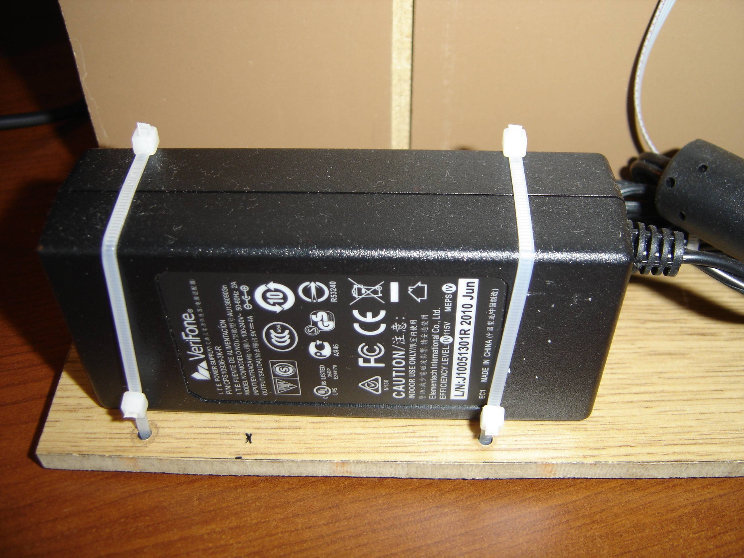

Power:
The energy passes through metal plates, rubbing against the isolated motor body (brush). The motor design is wrapped with insulating tape, which is wound with metal strap, against which the plate is rubbing. The strap was made of braided copper used for desoldering. Its ends can be easily soldered in shape of a ring or solder a wire. What more, this material provides resistance to abrasion.
The second brush (VCC) uses the same solution as for the ground.

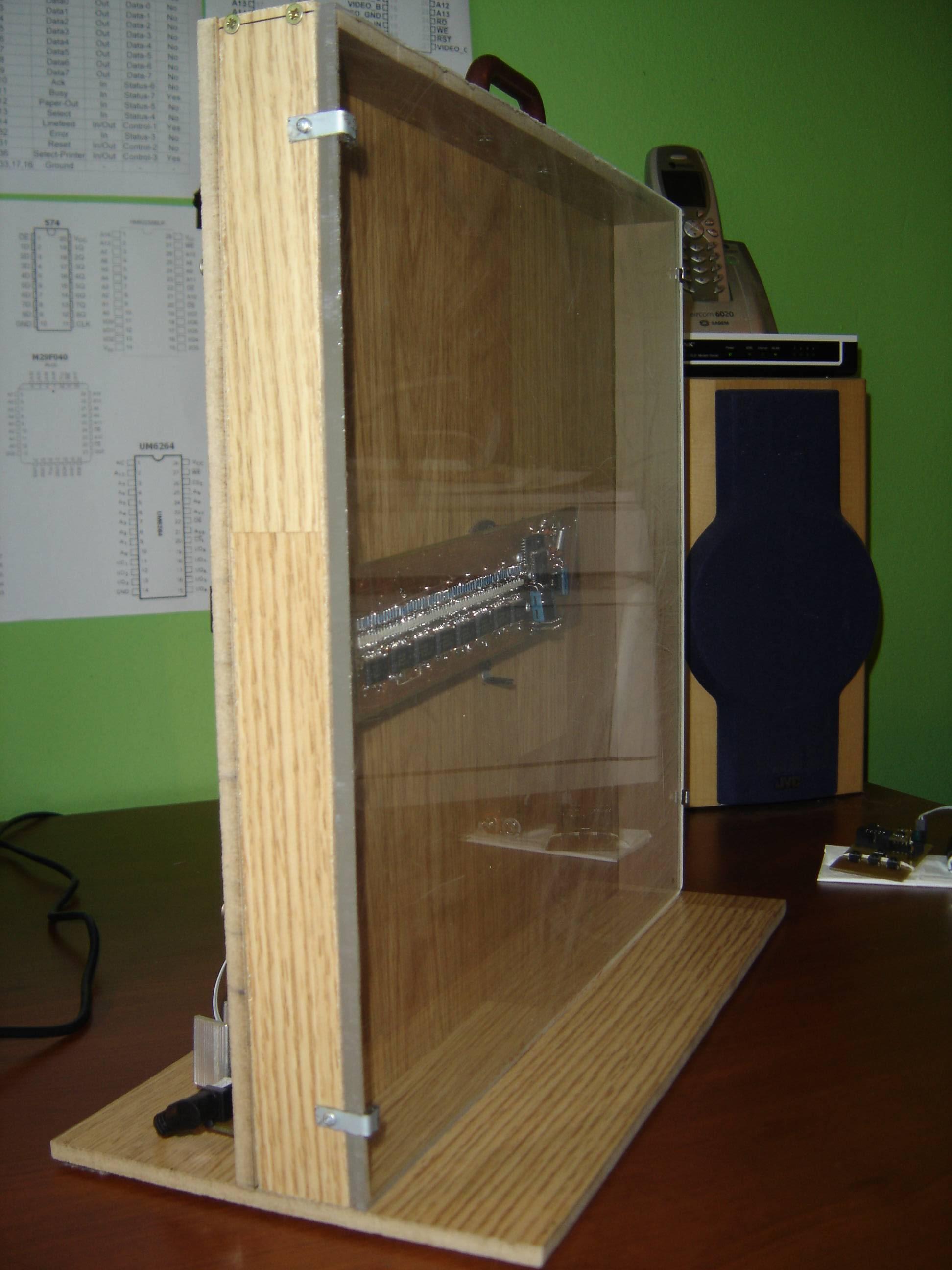

Wooden housing:
Wooden construction is another essential part of the design. It ensures protection against accidental touch and provides flexible shape. It was made of floor panels. Plexiglass was mounted on the front part of the housing to protect against touching.
