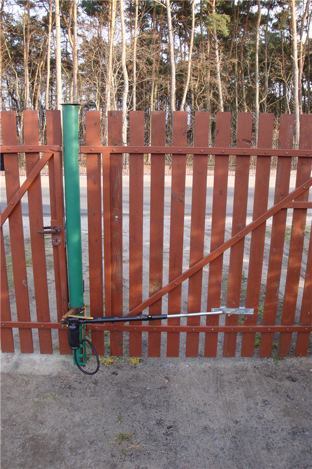

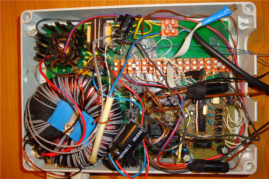

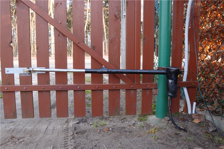

Two-way gate automatic
It is a project of controller and actuator for a two-way gate.
Technical information:
  • control: CPU Mega8 – program in Bascom
  • supply voltage: 230V
  • actuators: 12V DC + trapezoidal screw
  • control: a button or a remote control
Functions:
  • opening/closing with a pause
  • opening/closing of one side
  • open/close after a certain time
  • programmed angle of opening
  • smooth start and stop
Protections: photocell, overload control – measurement of turns
Additionally: a program to monitor engine speed and the performed control function
