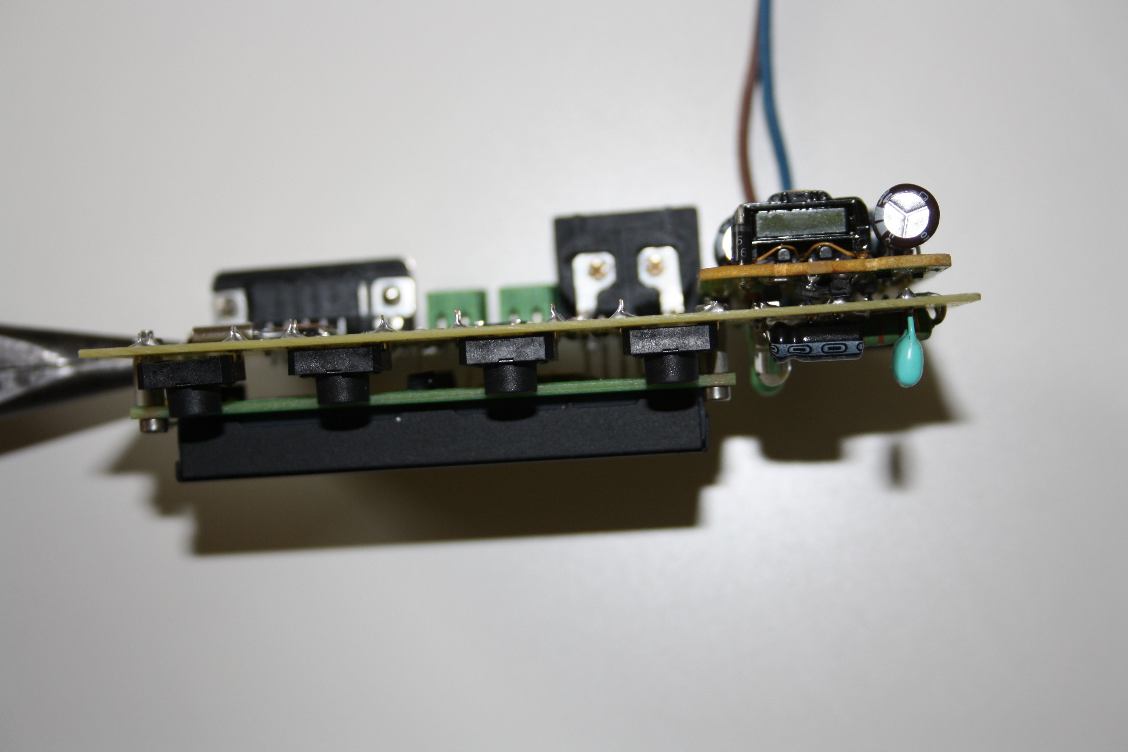

The system is designed to control the external device of alternating current based on temperature readings from two external thermometers.
The principle of operation is simple: uP reads the temperatures from thermometers and if the difference exceeds a set value, the external device is activated. The system has many options adjustable with four control buttons located just below the screen.
Functions:
  • the ability to set the temperature difference
  • the width of the hysteresis
  • the time of switching on the device
  • the time of switching off the device
  • the minimum temperature
  • the real time clock
  • ability to store the maximum temperature of each sensor
  • watchdog
  • RTC 3V battery-buffered
  • storing set parameters in non-volatile EEPROM memory
Construction:
The device is based on the AVR processor Atmega168 clocked with internal oscillator 1MHz. The processor works with the LCD display WC-1602A0 2x16 characters on the driver HD44780, specifically on the clone of that driver - KS0066U. Dallas sensors 18B20 are the thermometers connected through the 1-Wire interface. The system also has a DS1307 real time clock that communicates using the I2C interface. RTC is clocked by an external quartz 32.768kHz and has a battery to maintain time with power off. The role of the element that controls the high voltage external device plays TRIAC BT138 isolated by optocoupler MOC3041. Two control diodes – the green one indicates the connection to the controller power, while the red LED indicated the operation of an external device. The system is powered by a switching mode power supply (5V).
The software for AVR was written in C in AVR Studio 4. The system has an implemented watchdog support and read of the set parameters to the EEPROM memory.
Below there are some pictures.
