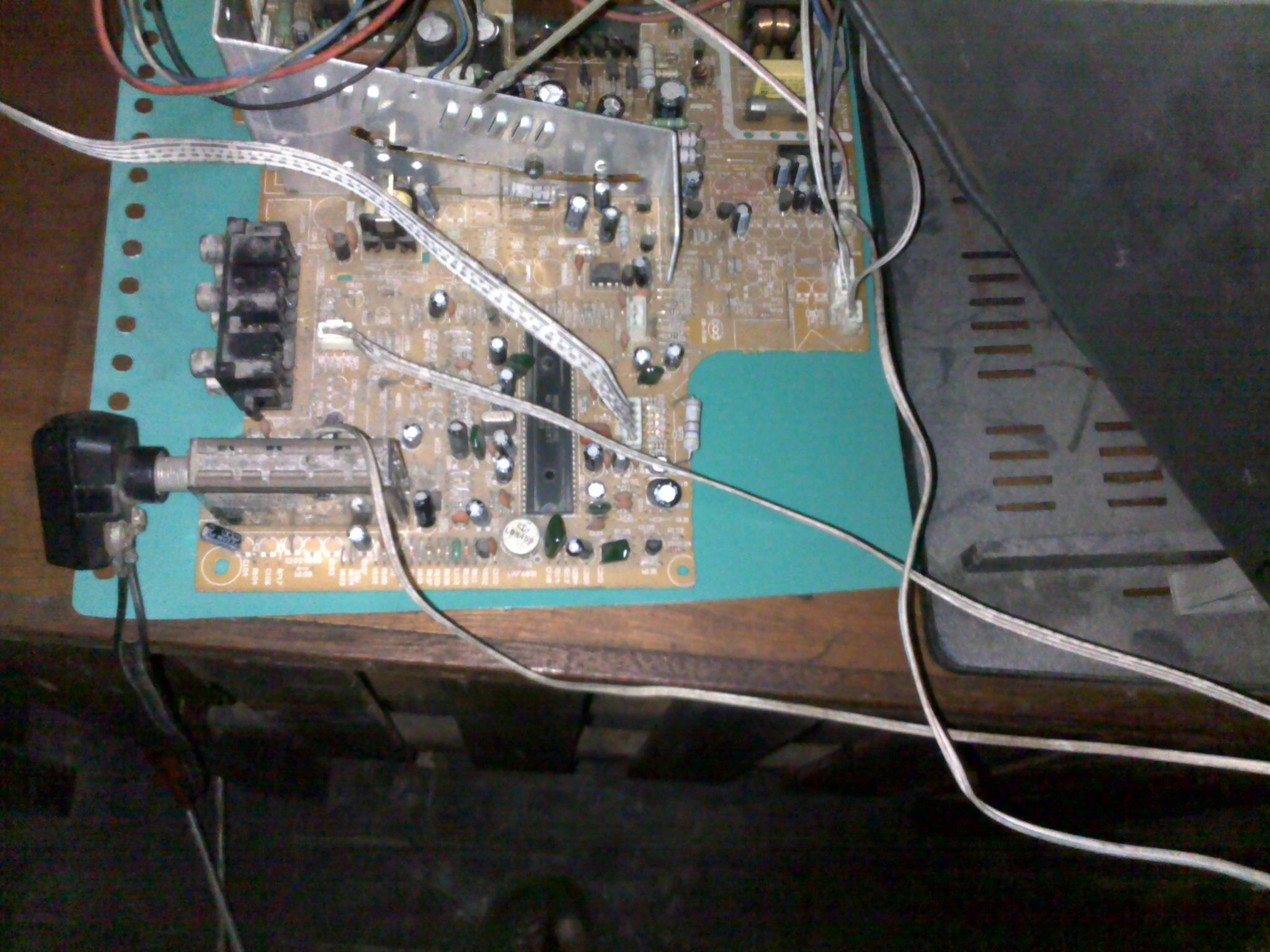

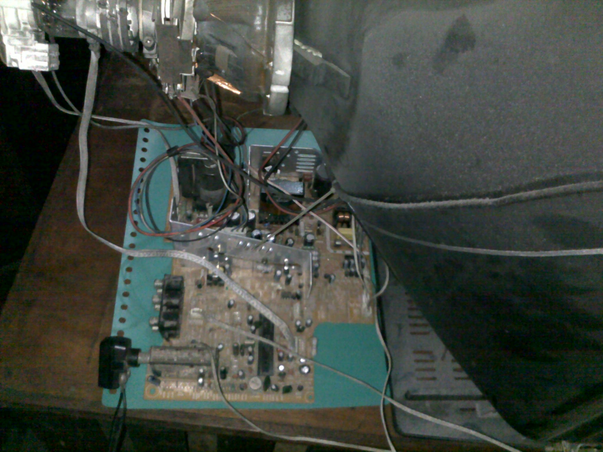

Is it OK to replace the main IC? I have checked its surrounding components and found no defects including the RGB Board on the CRT. This china tv's board is labeled ''Sanyo Board''.
Here are the pictures:
If you can get a replacement it may be your only option. These ICs can be hard to get hold of though.

What is the number written on top of the main IC?
Try to replace the IC if other issues are absent some where there might be slight power leakage in dry soldered areas check if everything looks good then try to replace the IC
there are several variations like LA76931S 7n** available is it the whole ic index no you posted
Yes there was 7N after the number,
By the way I resoldered its pins and at last! It works. Now another problem is that there are thin four lines above the picture, am I having problem with the vertical circuit?
