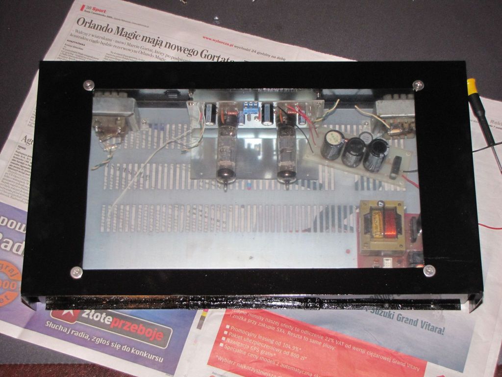

Housing:
Housing is an old one from a radio receiver.
The housing required some small fixing and was lacquered in black metallic. Additionally to present the inside, a hole was drilled in 3mm plexiglass. Below there are some pictures:
ECL86 tubes were 3mm too high, they were installed horizontally.
Pictures of final effect:
