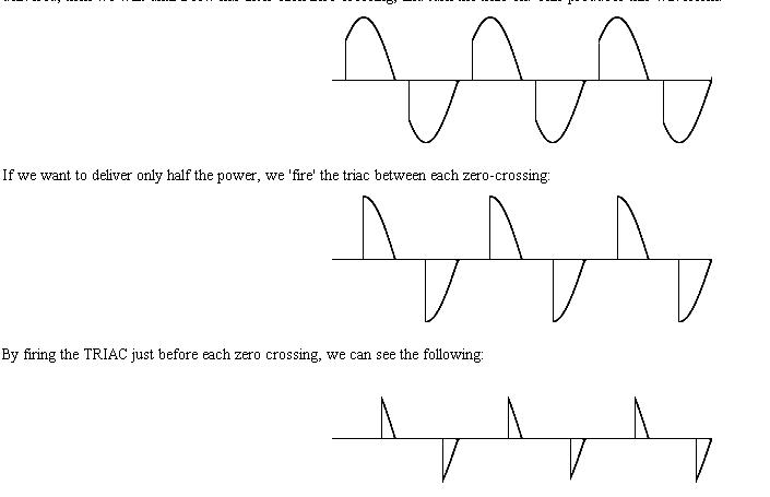

Hii Good Day,
I have problem designing circuit for controlling speed of AC motor. I used Phase Angle Firing Methode. I use Microcontroller (avr) for firing triac, but I got anomali result. Please check my design, (this simulation using proteus 7.2), I use AC signal with frequency 5 Hz and Vamp = 12V, but the output is wrong.
And here is my code please check : ( I use bascom avr as my compiler)

have someone already simulated TRIAC using proteus , how about the ac signal result?
the result supposed to be like this :
Please help me? Thank You
I think your main problem is you are using an optocouples with Zero Crossing. Intead you must use a non zero crossing one, like MOC3052.
