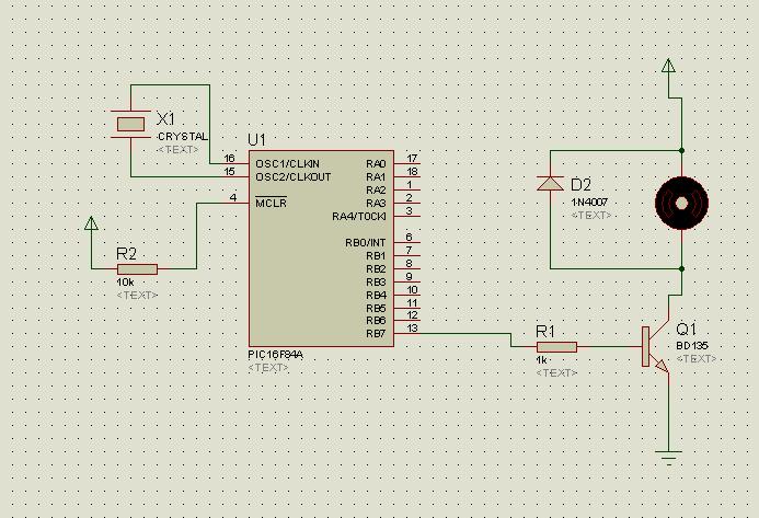

Hi all
I use bd135 to drive a dc motor with pic microcontroler
I use dc motopr with LED parallely.
It work fine with LED but
when i use it with a dc motor the led period change
and after some second the Led turn off and dc motor stop working
I use following program
compiler is mikoroelectronika
void main() {
TRISB=0;
while(1){
PORTB=0XFF;
Delay_ms(10);
PORTB=0;
Delay_ms(200);
can anyone help me??
my power is 5V-500mAmper
I guess it is because of my power supply
:cry:
The LED period changes bcz the motor works as Generator when the switch is open.
The controller goes OFF bcz of the Back emf use diode in reverse bias configrature across the motor to kill the inductive kicks

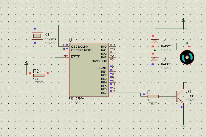

I use
Added after 3 minutes:
I use two diode and simulate the circuit in proteus
in proteus it work well but in real it first round with periodical speed and after some second it round fast
and after some second stop
I dont know why?
this is the circuit i use
Added after 11 minutes:
I test the following circuit too
but the result is that after some second the dc motor stop working
can any one give me the schematic of diod and dc motor circuit
please help
please help me
i dont know why it does not work
in second diagram the diode is connected in a right way
Replace R2 10k by 4.7k,
u r driving ur motor & controller via 5v Regulator ??
whatz the specification of ur motor
V?
I?
