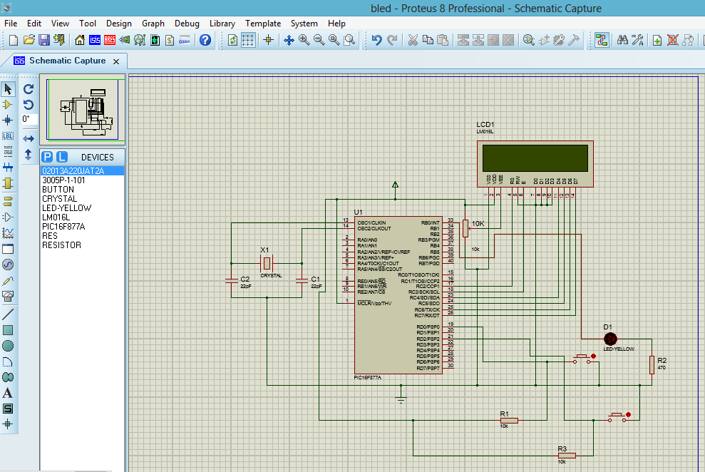

I'm new to micro c . Need to turn Timer1 on pic16F877A after pressed a switch 1 and then turn it off when pressed switch 2, then displaying the period of the time on LCD. Plz help me someone...it is urgent...
I attached proteus simulation picture as well as micro c code that i tried... but i don't no whether it is correct...

What is the problem with your setup? if I will suggest implement an interrupt timer that Blick the led at a fixed time interval. Then the other part can follow.
Please zip and post the complete mikroC project files and Proteus file.
In question you have asked for timer 1 and in code you have written for timer0. Please check.
Also, interrupt function should be defined as follows:
void interrupt name()
Amit
No, in PIC all interrupts have single vector. So, the routine is common. Source is determined by checked corresponding flags.

You can use single timer for 100ms. Use interrupt for checking buttons and increment timer. Simple task.

if you want a 10ms resolution (then a 1ms accuracy is not possible) then:
* set up timer for interrupt 10ms.
declare run as bool = 0
on every timer tick:
* if START = pressed then  RUN = 1
* if STOP = pressed then
    if RUN = 1 then
      RUN = 0
      display COUNTER
      COUNTER = 0
* if RUN = 1 then counter = counter +1
end of interrupt
main loop: nothing to do.
Try to program this.
Test it.
Then give us your program and the results of our test run.
Good luck
Klaus
