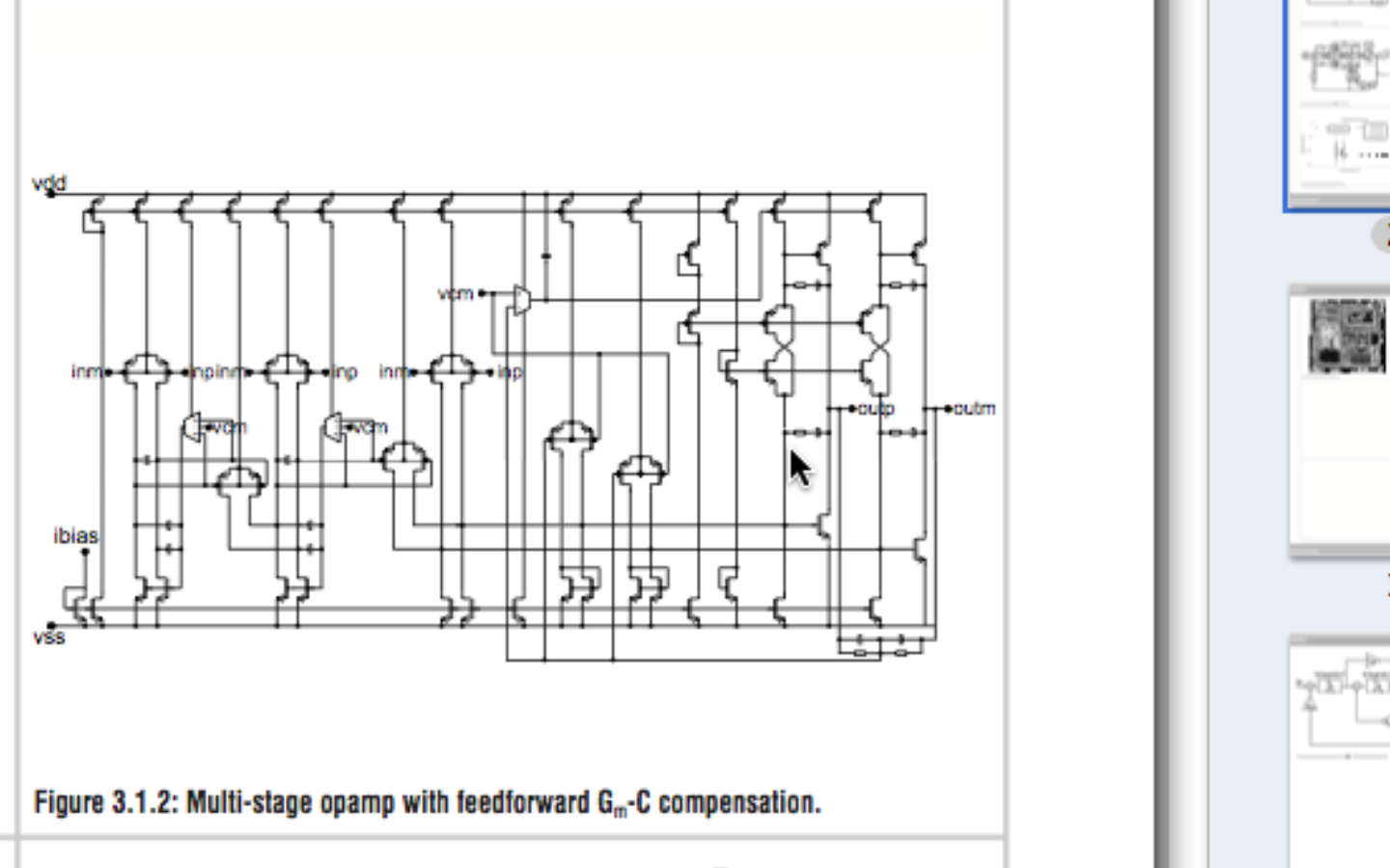

I have found that some comparator circuits uses two differential stage one after one to get high gain, and from here i got the idea to do this in normal operational amplifier
the first stage is fully differential output and the second one with single ended output
I know this is an old post, but just wanted to add a comment. In designing multi-stage amplifiers, using diff to diff to diff and repeating has become common in designing amplifiers up to 7 stages reported by ADI last year at ISSCC and still resulting in a stable design. I have designed my self up to 5 stages, taped out and it works like a charm! see attached image.
