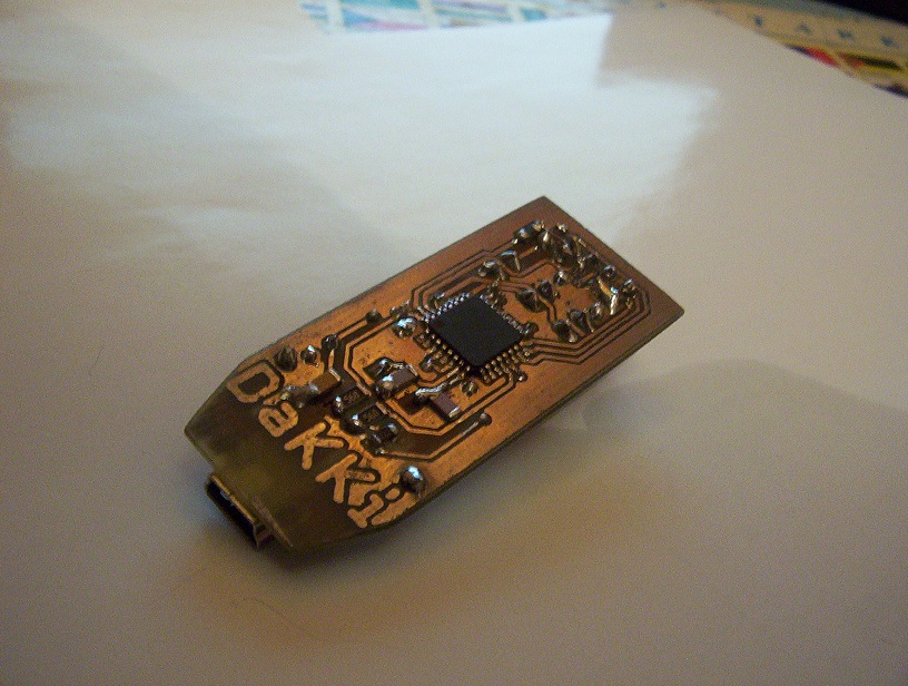

This programmer was designed to solve a problem when a computer does not have a LPT port to program anything on STK200 on the “spider”. Here you can find the famous AVR programmer – USBasp: fischl.de - USBasp - USB programmer for Atmel AVR controllers.
The board that looks like a pendrive was modified. Instead of USB port, there was applied a miniUSB. The project was made in SMD version with Atmega in TQFP32. The boards were made by thermal transfer method, tin plated in solution.
The board was made with stands to program most AVR used in constructions
AVRDude with the graphic overlay was used to program.
