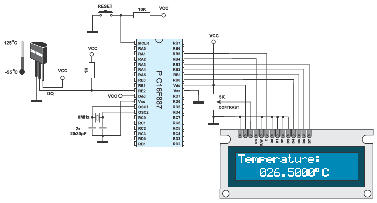

Im using pic16f877 and DS1820 sensor to measuring the Temperature. But i could not find the real value. im using the same code that is used in the example of mikroC library.here i attach the circuit diagram and the code. Is there anyone who can help me?

As what Tpetar has just said,
but most importantly the Pic chips only run on 5V or less, your diagram has a 9v battery directly connected, on a real circuit that would burn things out straight away !
@tpetar I know the lcd connection is ok! i have used it in proteus simulator on different purpose. in this project ive got the reading in display but it is fixed at 000.5000. i have already tried but it is same.
Your lcd connections are good enough to work in proteus but will not work on actual hardware.
Pins 1 2 and 3 are ignored by proteus; it does not need anything connecting to them at all.
However on actual hardware it must pins 1 2 3 must be connected as shown in tpetars diagram with a 5k or 10k trimmer for the contrast.
In practical terms you cannot resistor down every device to run off a 9v battery, you must use a 5v regulator.
Again it seems to work in proteus but will give you all sorts of problems in hardware.
Your resistors are fixed, the battery voltage is not.
