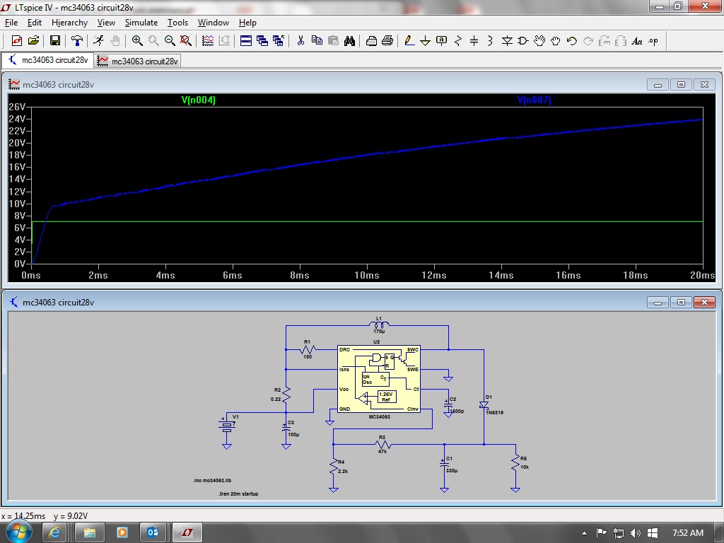

Okay,
I have made my circuit but im not getting an output voltage of 24v from the IC.
Can anyone suggest what i neeed to do.
I have made the LED come on at 59C and the voltage increses from 1.5v to 8v from the opamp.
I get a 8v output from the op-amp and the goes to the input of the boost converter but in getting 0.2 v out of the boost converter :-(.
It looks to me like you're trying to make the 741 op amp be
the power supply for your boost converter. Are you sure,
really sure, that the op amp likes that plan? Most are
not real big on sourcing current, and the startup phase
might never even take off if you can't get past the input
undervoltage lockout on the boost converter part. The
input current draw can have "humps" which need a decently
low input impedance to get over, and a current-limited
output might fail at this. Like roller skating uphill.
Suggest you cut this apart and power pieces separately
with supplies you can know and trust, and look for clues
on your own bench (or e-bench).
And don't bet on freebie macromodels doing a complete
job of secondary features, like details of op amp output
current limiting and boost converter startup current
profile - the latter particularly is very much about circuit
design details, internal. And varies plenty with PVT, so
even if you get a happy answer, such a chain of dependencies
stands a good (bad) chance of failing later when somebody
looks at it closer and throws outlier samples into the mix.

Hi again!
I don't know boost converters, so I assume that they can be powered by a lower rail supply than they can create on the output, so you'll know if with 9V going into V+ it can create a 24V output.
More importantly, perhaps, If I have it right, according to the calculation on page 11 of the OnSemi datasheet it says: Vout = 1.25 * (1 + R2/R1).
Check you haven't got R1 and R2 reversed on just your schematic or possibly in your real circuit, you might be creating 1.3V output instead of the 22.6V the calculator tells me you'll get with R2 as 2K2 and R1 47K.
If you make R1 50K you'll get a hypothetical 23.97V output.
https://www.onsemi.com/pub_link/Collateral/MC34063A-D.PDF
Good luck, that's a nice circuit.
Hello,
Iave had a little play around with R1/R2 and i can get the voltage to change but i can only seem to get an out put of 7.6V from the boost with 7.7V going in :-s
Thanks for the help.
I think the software doesnt like the MC34063 it doesnt seem to show a boost for some strange reason :-S

I meant a boost of Voltage.
I have tried putting a 9V supply to pin 6 and the voltage output stays the same, nothing changed.
I have tried running the op-amp to different pins to find the trigger pin but nothing changed again.
I think i might try the approach of two Transistors to boost the volatge as the less components the better.
I simulated the MC34063 with LTsplice and it work fine with a volatge in of 7V and a volatge out of 24V.
Maybe its the proteus software

Im only simulating this circuit.
I could test on breadboard with components but i wanted to simulate first, as this is my first circuit design.
Proteus doesnt have a 5819 zener so i used a equilivant version.
I assume the 180 resistor is linked to pin 8 and the inductor.
Im sure its the software thats at fault.
I think im going to change my design so that there is a contant 24V flowing through the LM35 and when the temp hits 60C the 24V cuts off to 0V.
Somehow
Cap values were entered incorrect.. Always Double check.. uF not F
