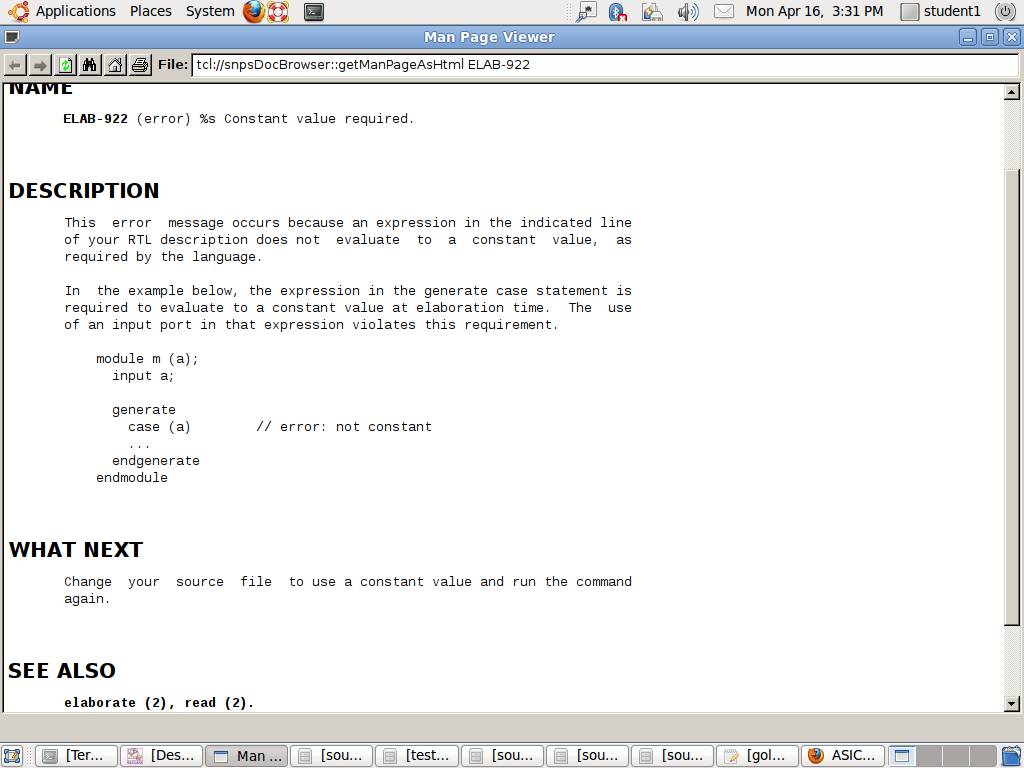

am synthesizing my vhdl code in design compiler in that during elaboration i got following error::
/home/student1/SNPS-2/source/golombcoding.vhd: 72 constant value required.
description of error is as shown below.
error description is as follows:
