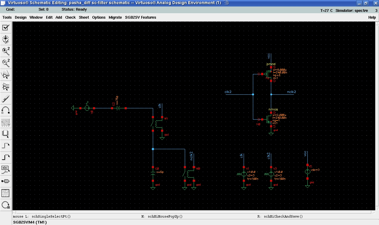

so i used my own sense and have simulated the following circuit with the pss and pac analysis settings given in figures attached...The idea is to simulate an ideal switched capacitor first order low pass filter with cuttoff frequencies of 1000Hz. The non-overlapping clock frequencies are 20KHz and input frequency is 100Hz....The switches used are ideal ones with on resistance of 1Ohm and off resistance of 1TOhm....
The calculated value of Switched capacitor equivalent resistance is Req=1/C0*Fc=1/(1pF*20K) =50M and cuttoff frequency of lowpass filter is 1/(2*pi*Req*C1)=1/(2*pi*50M*3.18pF)=1000Hz....The PROBLEM now is that the simulated value of cuttoff frequency does not agree with the calculated results.. I am not sure what the problem because i am using ideal circuits at this time....I have tried to change the clock frequency, input frequency, switch on resistance, output capacitor value, switched capacitor value but the problem remains the same...One thing which i have observed is that if i decrease the switched capacitor value, the deviation between calculations and simulated results become less but still not close..for example changing capacitor from 10nF to 10pF decreased the deviation but not much..

I've tried a switched-capacitor approach to simulate highpass RC-network. Circuit is the following
Equivalent resistance is equal to 1/(5p*100K)=2M, thus -3db frequency should be 1/(2*pi*75p*2M)=
1.06K. the following plot shows the result of pss+pac simulation
The simulated -3db frequency is near its calculated value. The overall attenuation is 4.7 db is due to switching operation, i think.
When i tried to use clock 20k this circuit didn't work as well as when clock 100K.
As for your circuit, i don't think it works like a lowpass RC-network, because (as i understand) switched-capacitor approach lets us simulate grounded resistance (like in highpass RC), but not floating (like in lowpass RC).
Regards, pavel.

Pavel, in principle, you are right - as far as the simple S/C equivalence based on the Euler-approach is concerned. However, using the bilinear approximation you also can replace floating resistors.

I also noticed that you get a more accurate frequency response when the clock switching frequency is 100 times greater than the filter cutoff frequency.
Can somebody please explain why this is the case? Is it because you have a lot more samples ? or because parasitics and noise are reduced at higher clock frequencies ?
Thanks
I think that's because there are more samples on signal period, so output signal can more precisely track input.
Thanks
No, it's not as simple.
You should not forget that the S/C technique is an approximation to time continuous operations. Thus, there are errors when you come closer to the frequency which equals the clock.
In detail: Consider, for example, a simple first order lowpass in S/C technique.
From the time discrete analysis you get infinite at the clock frequency - in contrast to the real RC world. However, since you always have a sample-and-hold-effect at the output of the filter (opamp) this "pole" is converted to a zero at the clock frequency.
But there is still an error in the vicinity of the clock frequency if compared with RC.
That's the reason for a clock which should be higher than the desired cut-off by at least a factor of 50.

I am trying to simulate the response of a simple low pass sc filter. The structure is derived from a classical RC low pass. So all i did was exchanging the resistor with a sc-resistor. My circuit and all settings can be seen in the attatched files. Now here is the thing i just dont understand:
The simulation runs fine and shows a low pass characteristic, which is good. And the pole is changing with different sc-frequencies, which is also good (diffFreq.png).
BUT, it does not change in any way when i change any of the cpacitances (diffCap.png). It just shows the exact same behaviour.
Does anyone know what the problem is??
