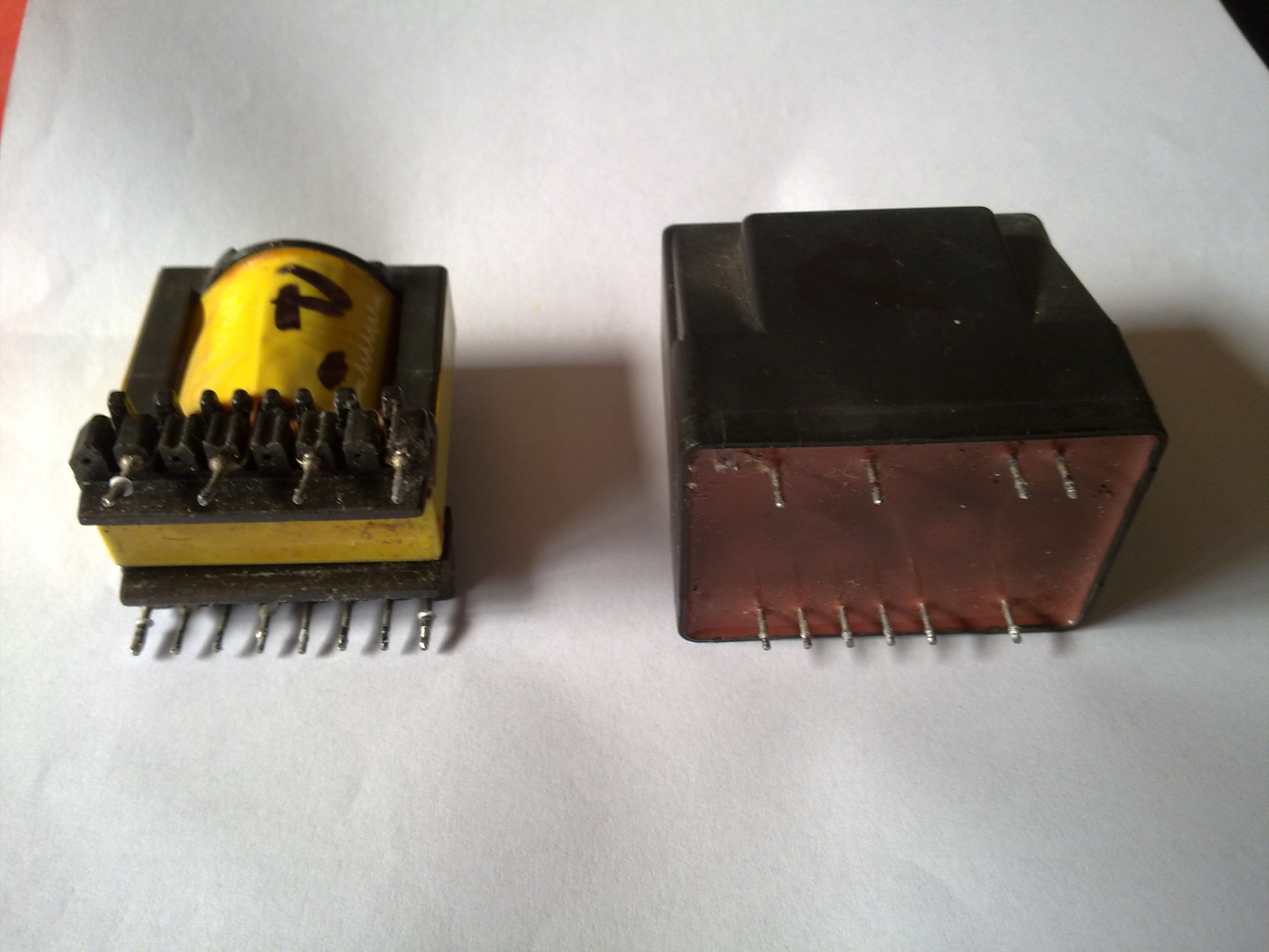

i would like to realize an power supply swicthing, using an "transformer" recovered from an old tv colour or pc monitor as that in the picture.
in output i will have need of 12 vdc and 1 ampere about.
i read some documents of the swicthing supply and i have seen that exist various type of this power supply.
if i understand good the first thing to do is
straighten the voltage ac in voltage dc with a brigde or four diode, after is need send this voltage to an "transformer", using an mosfet and an integrated circuit that pulse at high frequency.
i have seen that these transformer have two windings primary, and more windings secondary.
is possible to realize an power supply with these transformers
in the pictures there are two different transformers recovered from tv or pc monitor.
the side with four pin is primary winding on both transformers.
thank to you every for any help

Without knowing more about these particular transformers it is pretty difficult to move forward. I'd suggest focusing on building the desired PSU rather than making these transformers a focal point.
thank you kam1787,
I would like to built an power supply and i thought of start to these transformers because i have been that are all very similar and this can help me for understand the operation of the circuit.
Looking always the section of power supply of old tv or pc monitor, i have been that after these transformer, there are always three value of voltage.
My idea was to use one of these voltage and learn something on these power supply type.
I would like understand well these circuits that today are in any appliance.
Thank to you for any help.
Regards erchiu
I suggest to review reference designs for an industry standard flyback switcher IC like UC3842. A simple circuit can be found in the datasheet.
You'll notice that one of the primary windings is an auxilary power supply. You should figure out a way to identify the windings ratio and polarity of all transformer windings, it's necessary for your design.

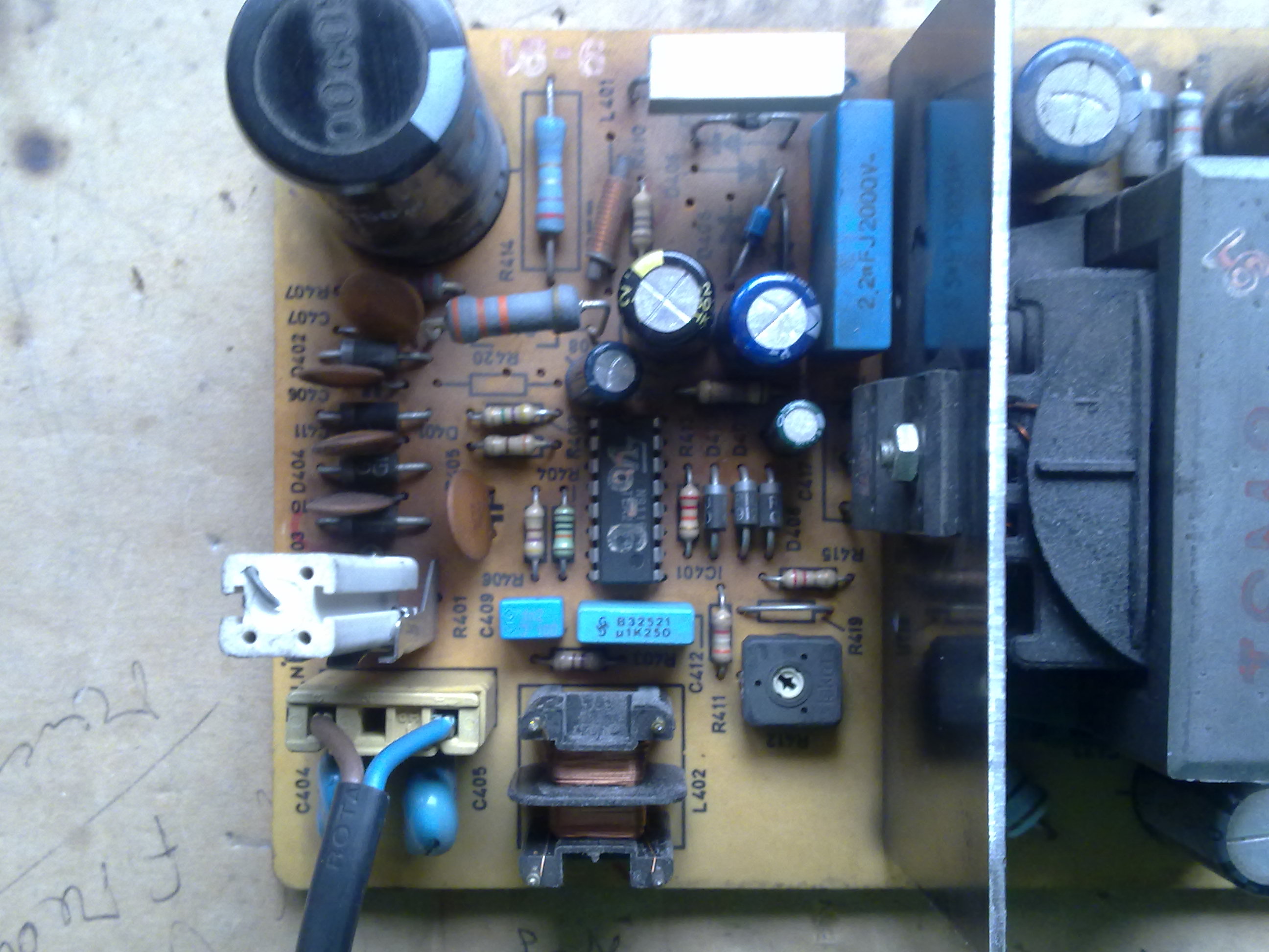

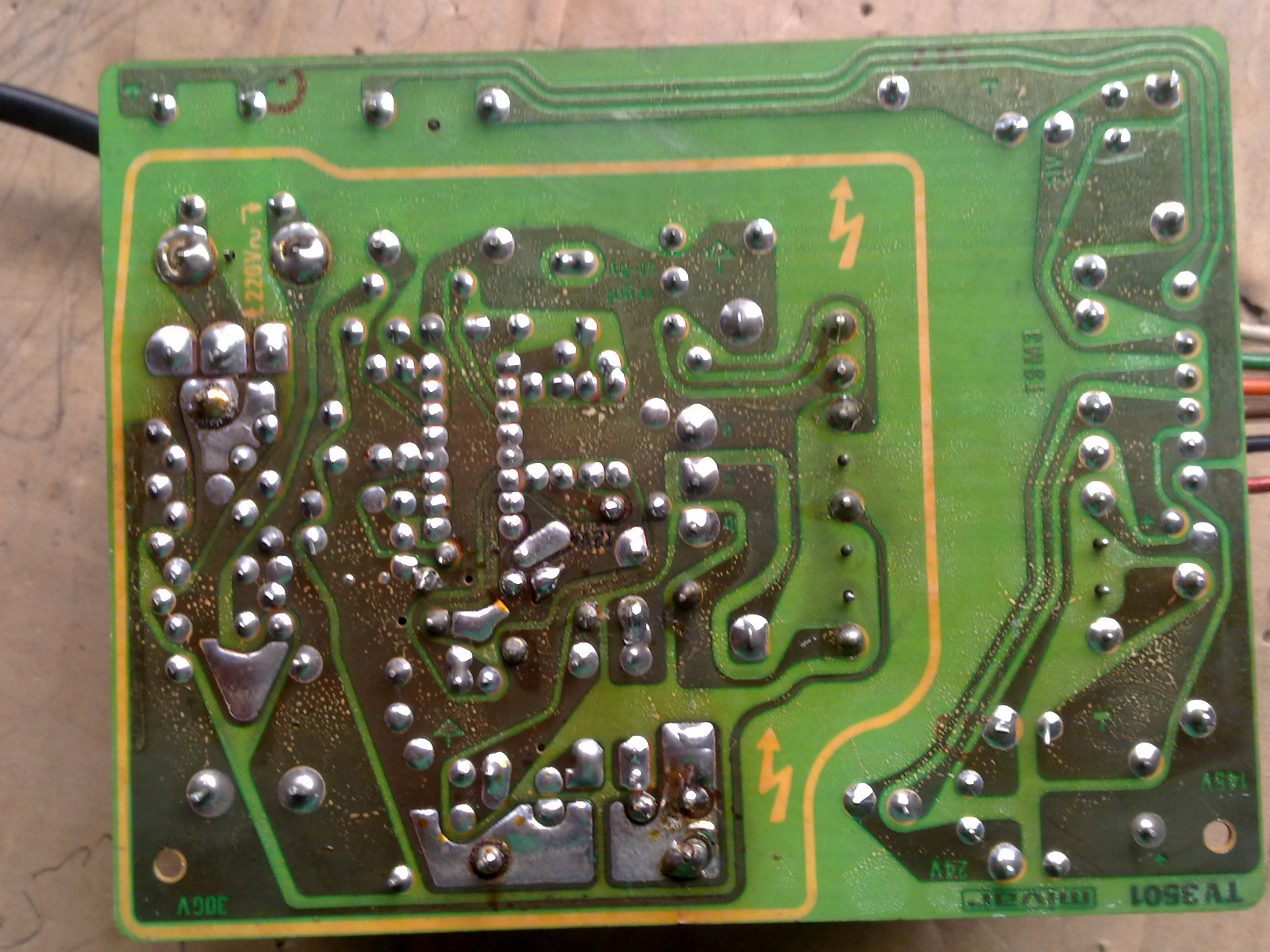

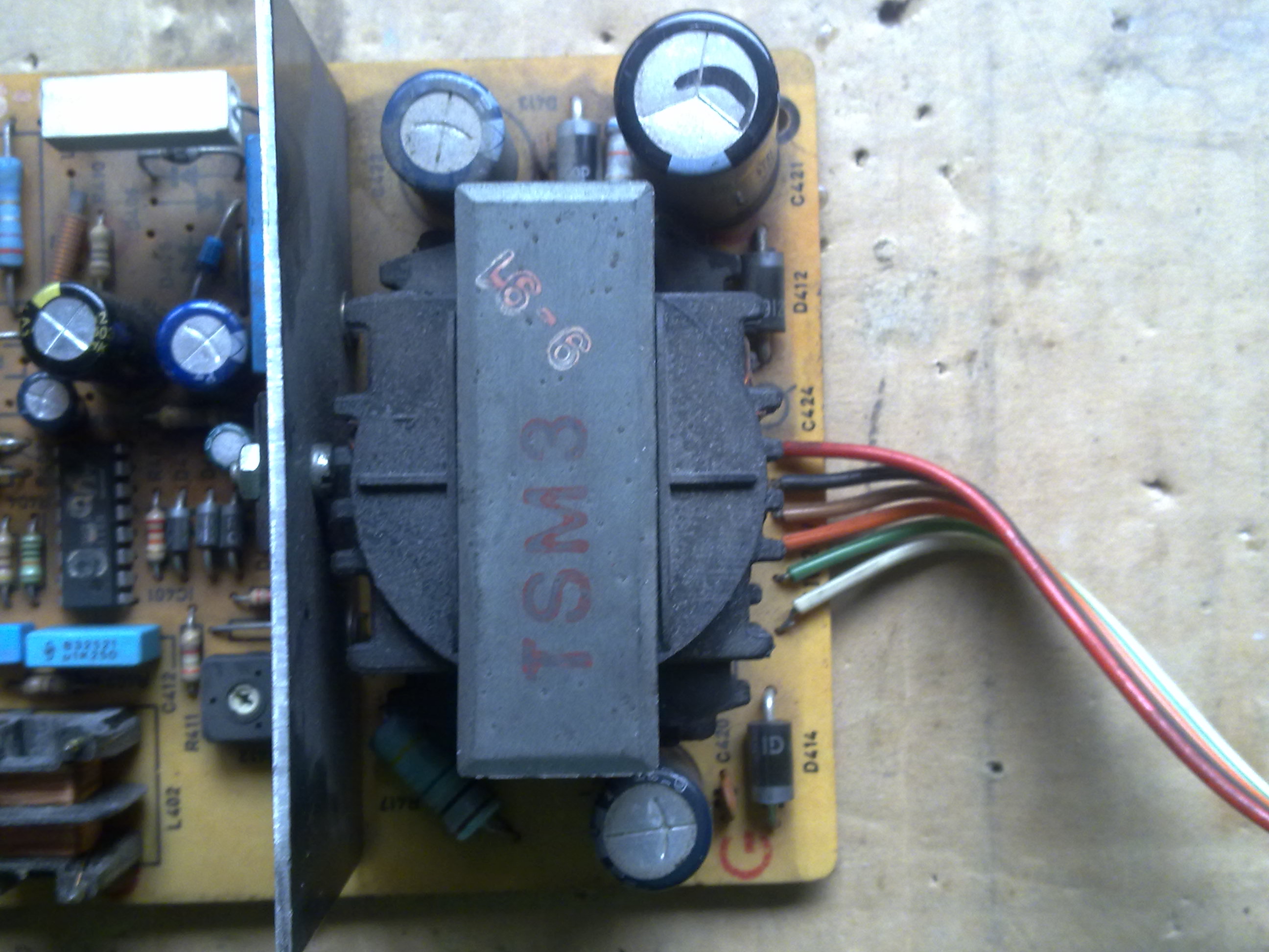

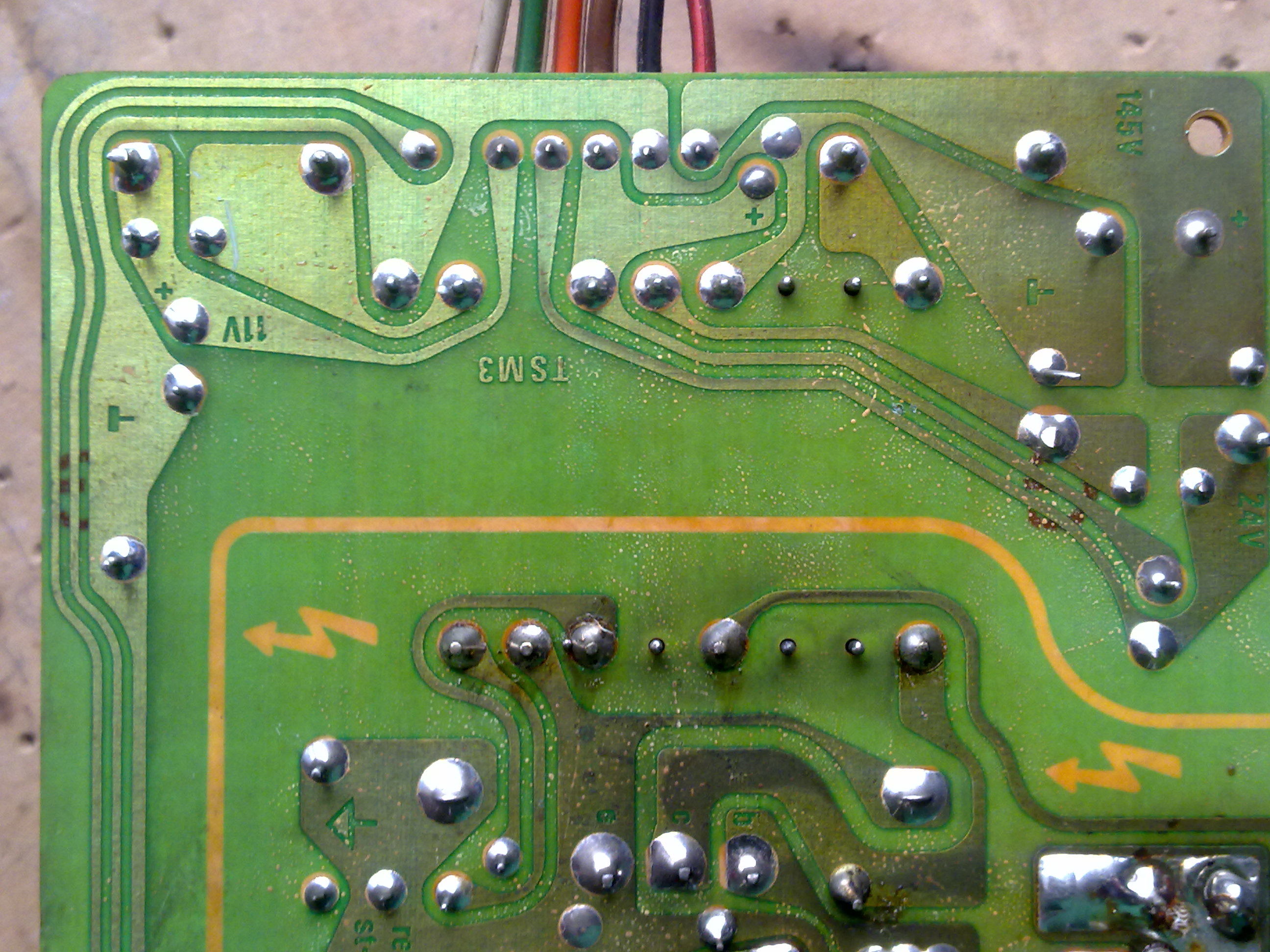

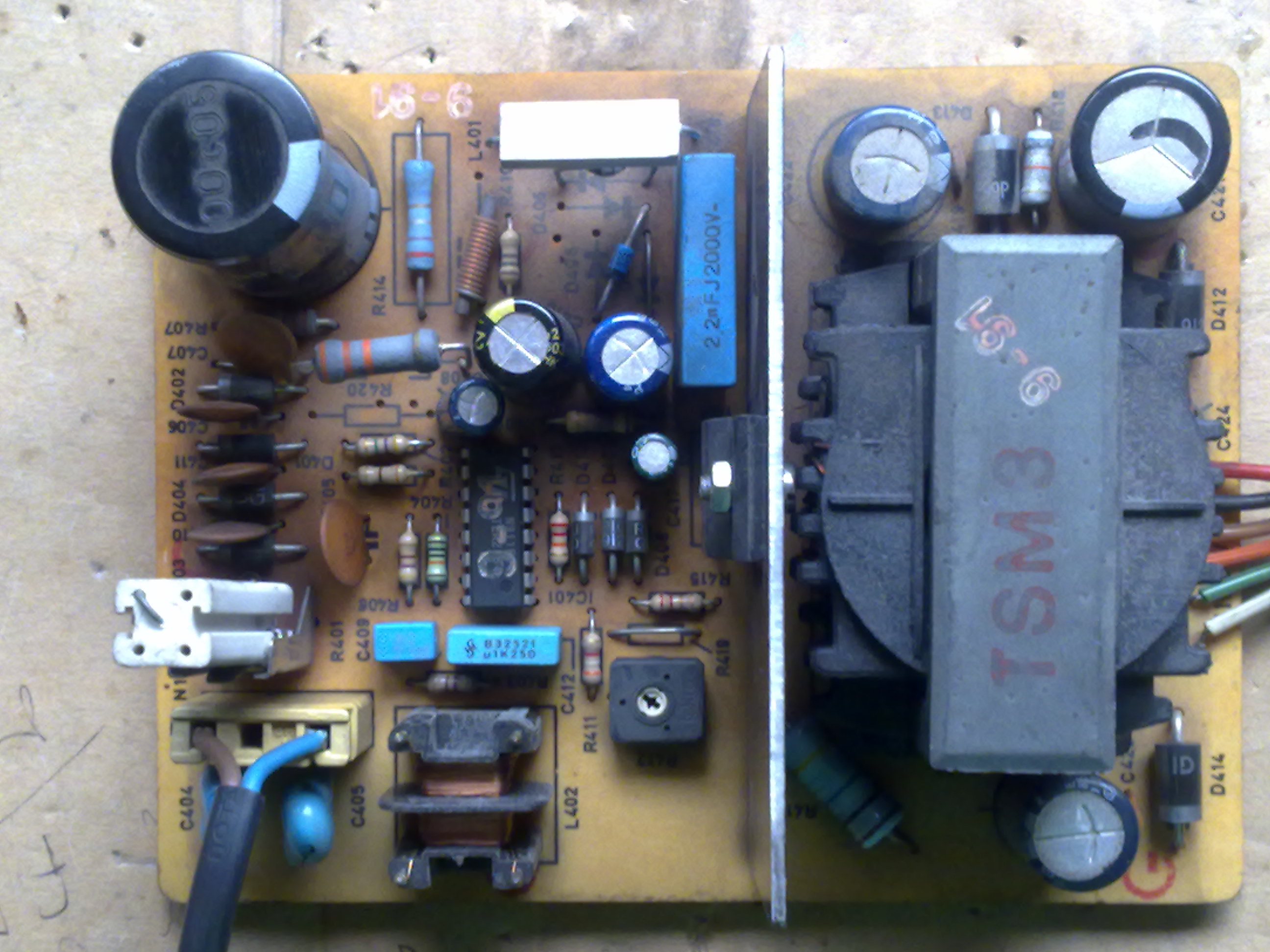

in these days i found into my things one power supply of an old tv, separate from the main board.
there is the socket of input (220 vac) and a socket of output with 5 wires.
on the board (track side) there are the some voltage values indicated.
following the tracks i understood that each of these wire is an output:
red=145 vdc
blalck= ground
orange=24 vdc
green=11vdc
white=i don't know
brown= i don't know
i tryed to supply this board with the 220 vac but i have only the output between green wire and black wire and it's 11,9 vdc
because the is not the 24 vdc and there isn't the 145 vdc?
there is the white wire that i not understand good its function
maybe if is not connected to the rest of circuit the IC not issue the other output voltage, or is the power supply circuit has some problem?
i post some photos of this board
thank you so much everyone
regards
erchiu
maybe i understood.
The IC in use in this power supply is the TEA2164 and i have seen that it working with another IC the TEA2029 (placed on the main board), i think then working in master/slave way.
The question is this:
Is possible to change this configuation and to use only the IC 2164?
