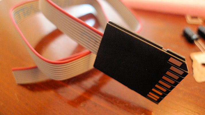

I was planning to try some emulation a while ago, but didn't really pursue it, might take it up again one day.
I got as far as this:
Or in other words, not very far at all!!
