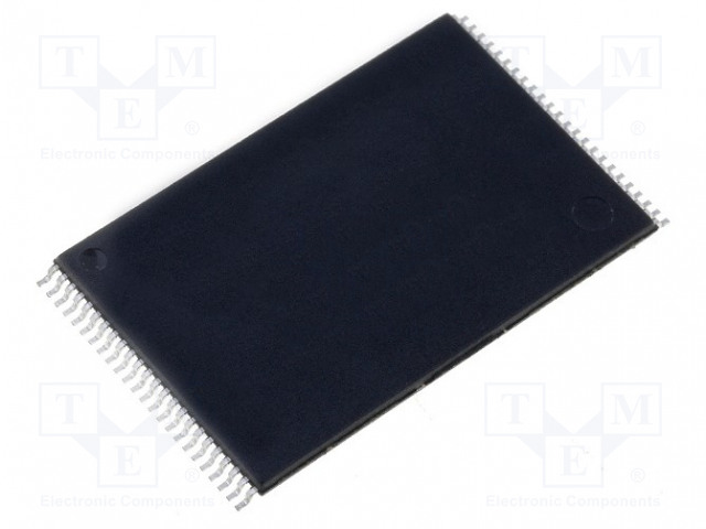

Now I would like to connect better camera sensor with full HD resolution (camera with parallel interface). In FPGA design with VGA camera the frame-buffer had been made in Block Memory (in FPGA chip), but for full HD resolution (1920x1080) the amount of BlockMemory in FPGA chip is too small. So I decided to look for external hardware solution.
I would like to use Static RAM memory in external IC placed on PCB board connected with FPGA board. I would like to use 12-bit color for pixel displayed on HDMI monitor ( my FPGA board has HDMI interface). The minimu amout of memory needed for frame-buffer (HD) is 2Mega X 16-bit word. It is also important the type of case of selected SRAM IC in order to I be able to design PCB and solder memory chip to board. Currently I selected such SRAM IC:
It is SRAM chip organized as 2048K words by 16 bits. The single power supply is 1.65V-2.2V. Case is 48-Pin TSOP ,TYPE I ( 12mm x 20mm ) which I should be able to solder to printed circuit board. Here is data-sheet for this SRAM memory chip ( IS61/64WV204816ALL ):
I am not sure if I had selected optimal IC for this purpose - I mean the ease of writing driver in VHDL/Verilog for such SRAM memory. I am also not sure if driving such asynchronous SRAM in synchronic way from FPGA board would be working properly. If somebody can give me hints for such project i Will be very grateful.
Thanks in advance and regards
Asynchronous SRAM can be well interfaced with FPGA, you useally need multiple clock cycles per write or a multiphase clock to generate the write timing. Because asynchronous RAM is cheaper than synchronous RAM and better available, it's worth the effort.
