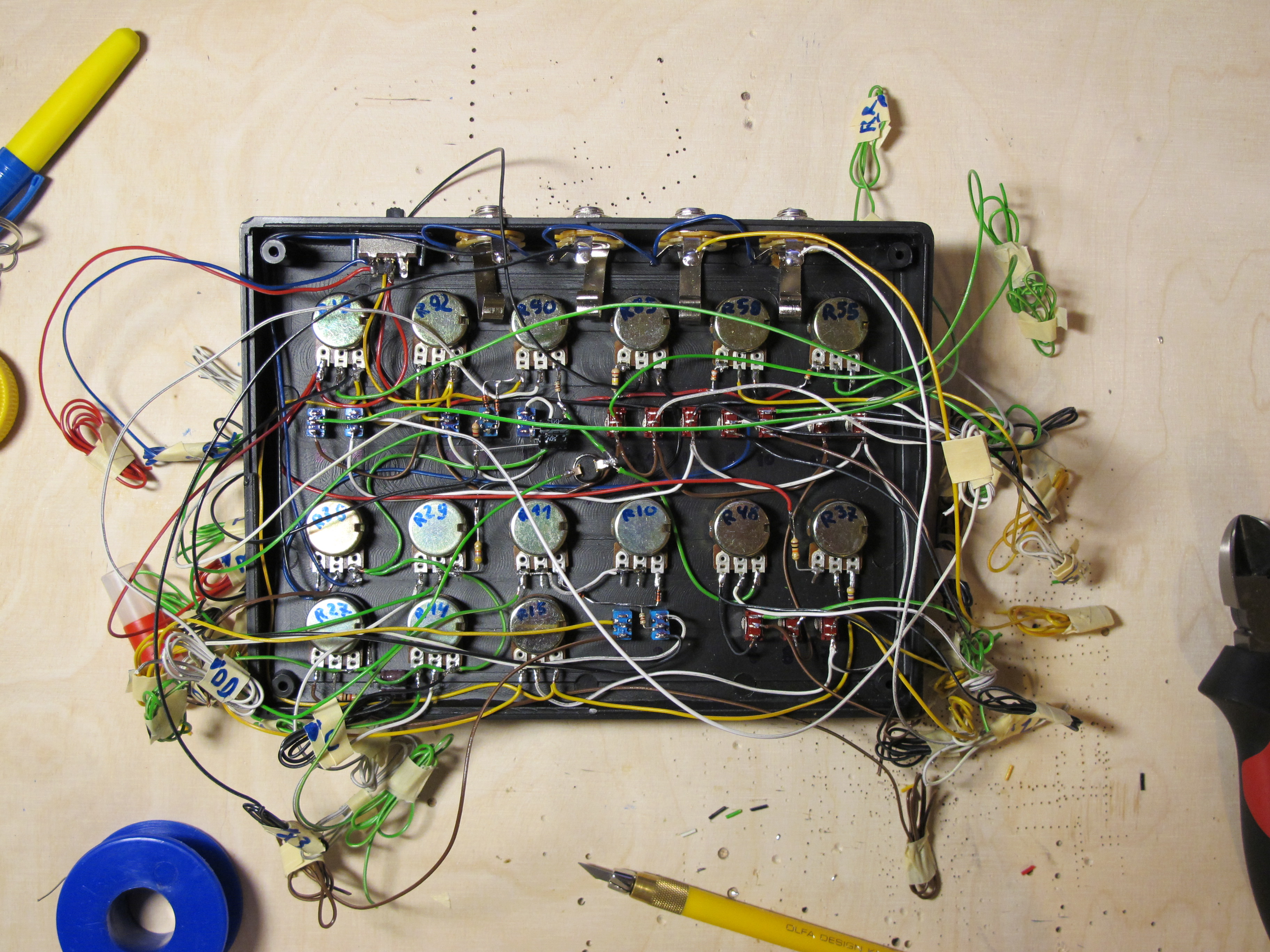

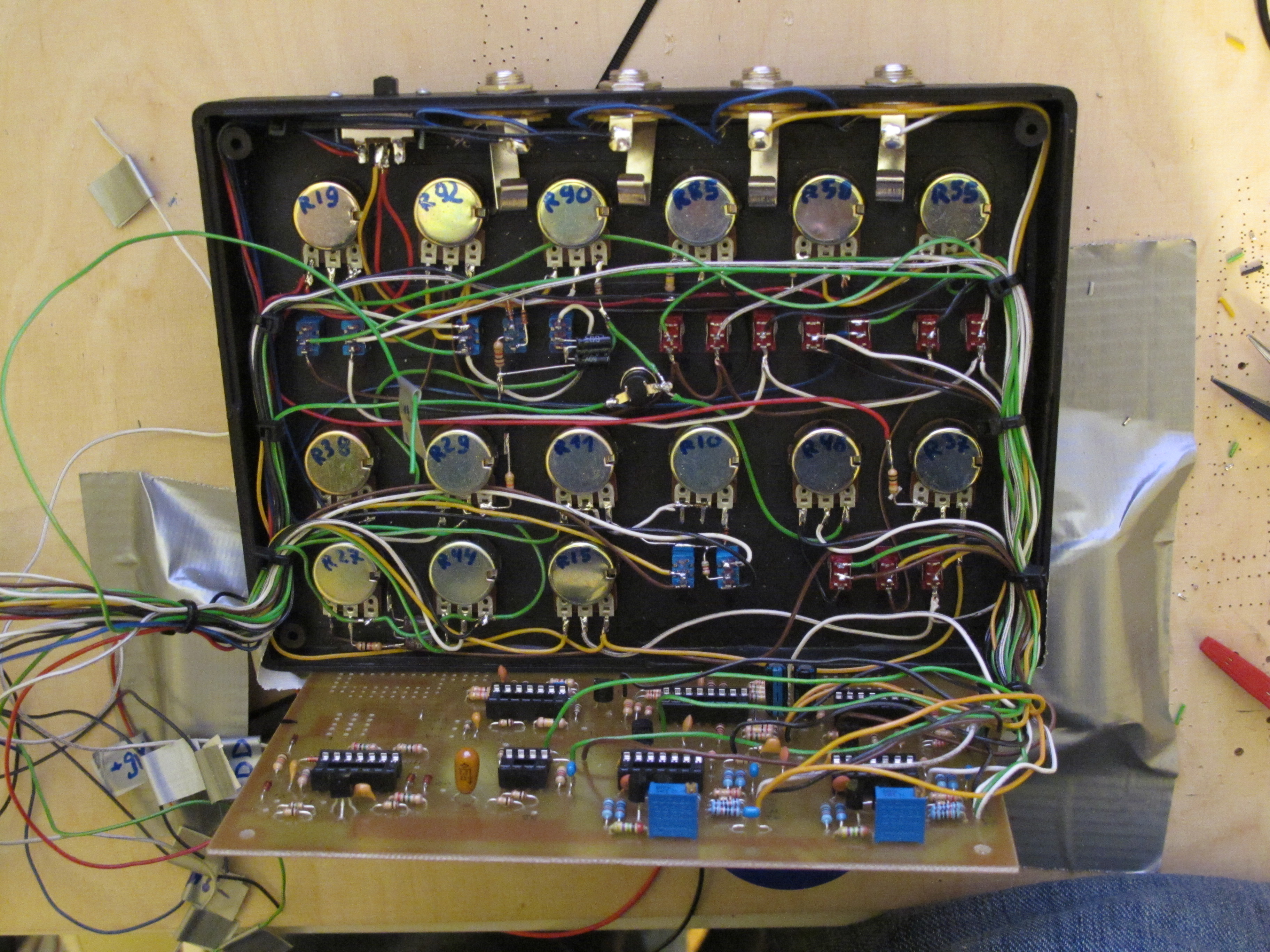

The device barely fits a standard Z-33A housing. Main problem was connected with the front panel. A total of 48 holes were drilled and about 15m cable was used. Description of the panel was made in InkScape, printed and laminated.

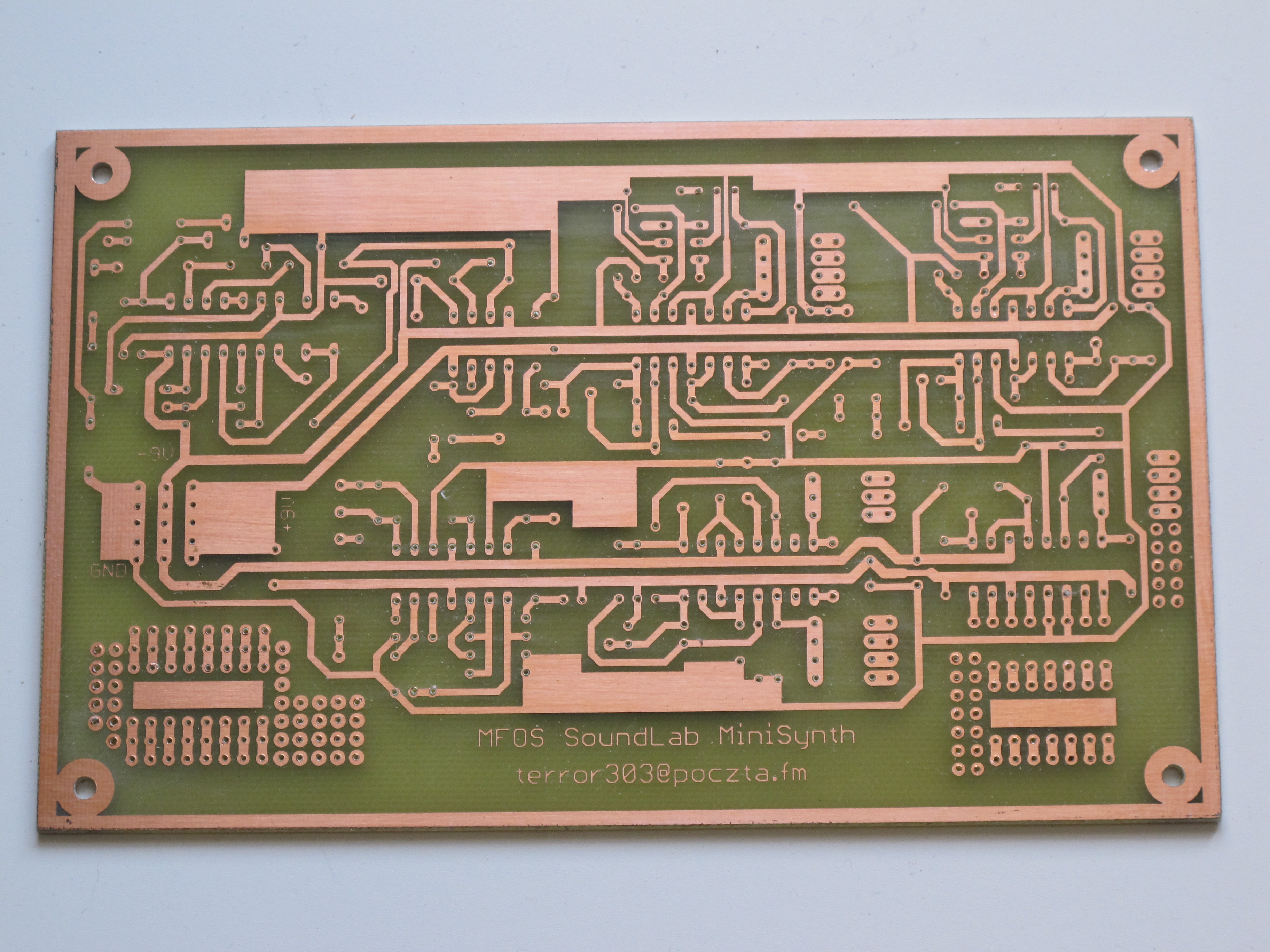

Views of the board and cables:
Fitting the housing:
